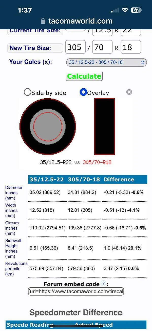

Assuming all things are equal that I don't know about, +58.5ET to +40 with a 20mm width increase and a 2mm sidewall height increase (4mm total height) leaves you at
20mm/2 - (58.5mm - 40mm) + 2mm = -6.5mm on the inside arc. Yeah you should be ok ?? you'll have more poke, but it'll be necessary.
Thanks for that! I’m still a little concerned because they said in the video they stick out a bit further but looking at +40 offset is a concern. I don’t see how the wheels would stick out more. I think stock is at 0 offset. I have spacers but would really prefer not to use them.
No, stock is at +58.5mm offset. So a +40 would bring the wheel out 18.5mm assuming the wheel width is the same, 9".
That does give you a little to work with on the interior arc rub, so long as you don't have a larger total diameter, a 305mm width should fit ok. Your total diameter is within 2mm, so not bad. I think you'll be ok 305/70r18
