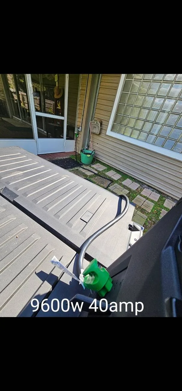

If you know how to have a portable generator power your home using an interlock switch (or manual transfer switch) the truck can do the same in case of a power outage. See picture.

Yeah. That’s the obvious way to do it on a budget.

Yea, and if you don't have an inlet box you can install one for about $80, the large extension cord will cost about $150
Or if you know nothing about electricity you can get an electrician to do it for about $200 depending on your setup.
VERY affordable and easy to do, and as a bonus any electrician can do it and you don't need Tesla to "activate" your inlet, or go through Qmerit.

Cost me $175 to have an electrician do this. The next day we lost power.
It worked.
