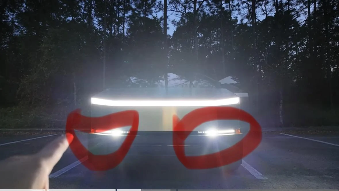

Are you sure it isn’t because of the fog lights? I’ve seen two CTs driving with their fog lights on and they are horribly angled and 100% blind oncoming traffic.

Huh? I don't think CT has fog lights. I just looked through the manual again in case I missed it and there is nothing in there about turning on or off fog lights.

I thought the lights below the light bar are fog lights as usually that’s the case. Either way these are really annoying to oncoming traffic. Something about them aren’t pointed right.
Those are the headlights.
Light bar doesn't project light over a few feet in front of you, it's the daytime running light.
oh learned something new lol
Then yes, it is the headlights that are terribly angled from the factory then.
They are not fog lights, they are headlights. And their aim is adjustable from the center screen.
