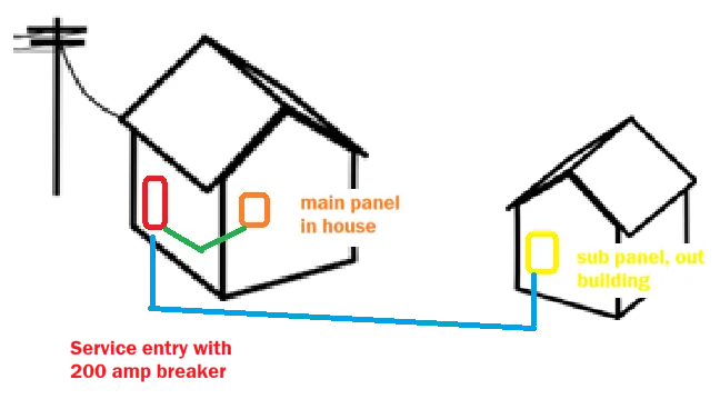

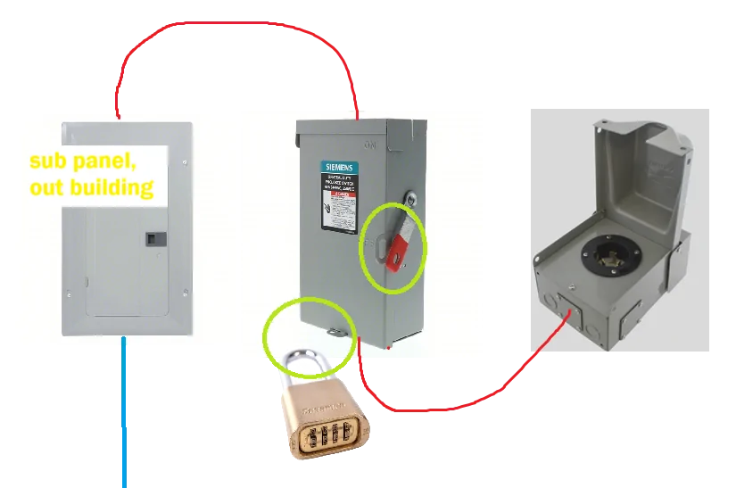

Agreed! it can be super dangerous. That's why I've been mulling over a simple yet safe solution for a while. I don't have solar, but good input on the interlock. In most cases, I would agree with a simple interlock device, but our setup here may differ than what most people are used to. Maybe a couple of pics will help illustrate.

  8. Verify that the [SIEMENS Safety Switch] is located in the "OFF" position, and padlock is in the locked position, [preventing the arm from being thrown into the "on" position" before we are ready]
  9. Plug male NEMA 14-50 [STW 6/3 + 8/1 Cable] into Cybertruck [or generator cordset into generator].
  10. Plug female end of (CS6364) [STW 6/3 + 8/1 Cable] into [NEMA SS2-50P 50 Amp Power Input Inlet Box]. Ensure that the cable is twist locked into position, and locking ring is tightened [if applicable].
  11. Once the cable to the Cybertruck [or generator] is secure and free of any trip hazard, unlock the actuator arm to the [NEMA SS2-50P 50 Amp Power Input Inlet Box] and place padlock into locking slot at the bottom portion of the [SIEMENS Safety Switch].
  12. Move the [SIEMENS Safety Switch] level to the "ON" position.
  13. Switch the breaker labeled "generator" to the "ON" position.
  14. [Enable] the outlets for the Cybertruck.
  15. Slowly start turning on the branch circuits that you want to run during the outage; enabling the largest load first, and waiting several seconds in between them [to ensure large loads aren't kicking off at the same time; thus gently bringing critical systems back online without having too much inrush current].​
And then reverse order from there when grid power is restored. There are of course some nuance and details left out, but that's the main idea. The safety throw lever that stands in between the Cybertruck and the subpanel is what makes this system simple, yet safe in the event of an errant actuation of the "backup generator" circuit"; regardless if the breaker is accidently turned or left in the "on" position. Granted, there is room for error if you utterly fail on all levels to perform the procedure properly, but we don't lose power enough to warrant an ATS. So this is the best course for now.
So for those of you out there with valid concerns about an interlock, I do agree. It's very necessary. But I'm likely going to chose to do lock-out-tag-out using padlocks on the enclosures themselves, rather than finding a way to interlock the inside of the panels. Less confusion this way. Plus I get to "clunk" a throw lever like it's the 1800s lol.
