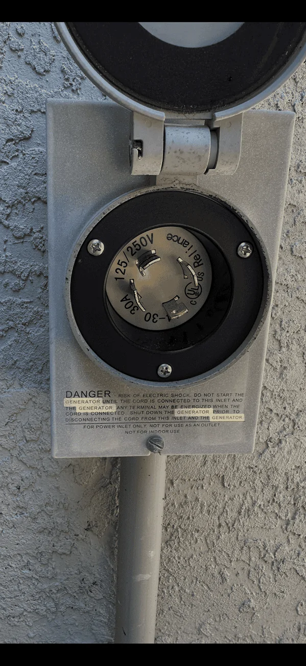

Hey guys, I have this generator inlet at my house. How can I tell if I have an interlock kit?
If I get a 14-30 to NEMA 14-50 generator cord am I good to go? (Will get a electrian involved before blowing myself up but want to understand what I’m working with. Thanks CT fam!

I'm going to guess that's not connected to an interlock, it's connected to a transfer switch. It could be manual or automatic.
An Interlock is going to be a "contraption" connected to your main panel or possibly outside that you will have to throw to engage the power.
A transfer switch is going to be a box, probably mounted next to your panel and probably having some breakers inside of it.
The transfer switch should switch automatically.
