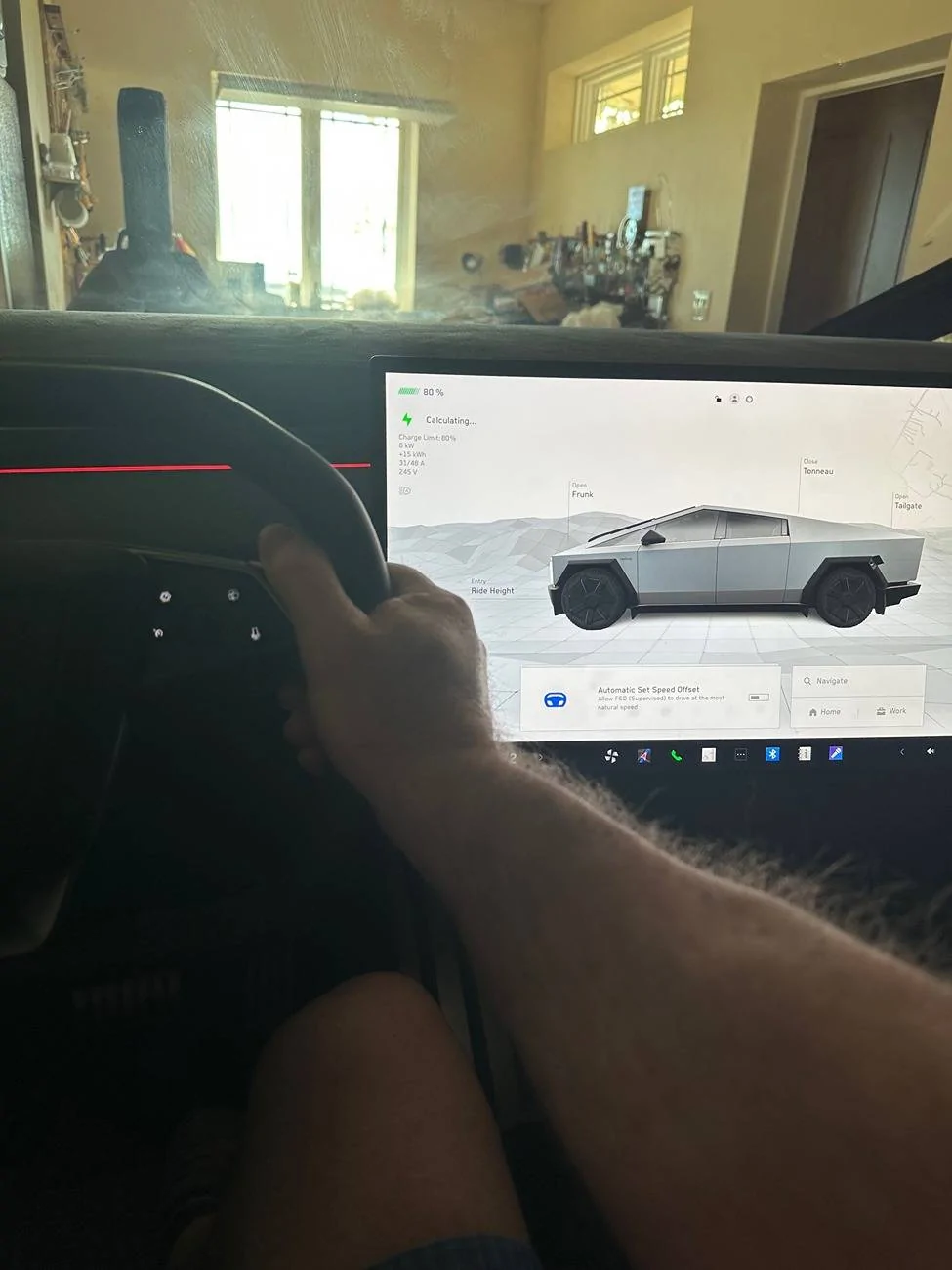

Does the fact that it is lower bother me? No, not really, I probably wouldn't even notice except now if my right hand is on the wheel, it blocks the lower left comer of the screen. See picture below. I may even attach a Magsafe phone holder above the screen now and it would not block any view out the window. So, yes, it is a big improvement on the original design and probably the way it should have come from the factory, IMO. Not only is the screen easier to read but items on the far side are now easier to reach. I am glad I purchased and installed it, one of the more beneficial accessories I have added to the truck.
Here are a couple of pictures from eye height.
