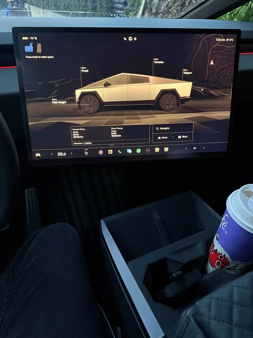

Are you happy with the screen? Does it seem solid and level?
I’m very happy with the screen. It’s flawless so far - but a #%^*^% to install. Installing the screen onto the new arm was so hard because the bolts have to align perfectly to catch the thread. But it’s all worth it.
Tesla Roadster 2nd gen AnySix swivel display installation info IMG_0334

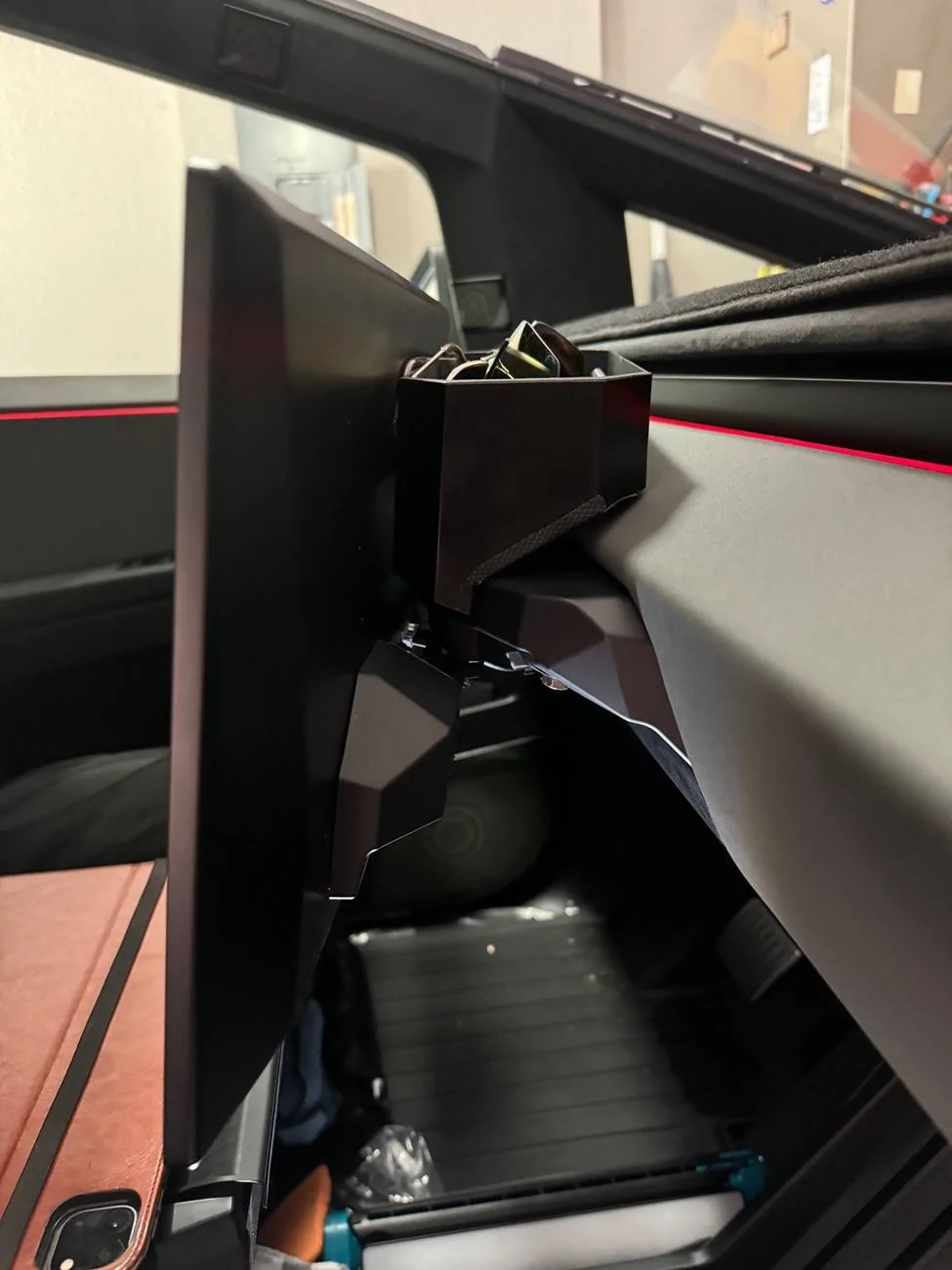

Btw, this is the (OEM) bolt that has been modified from the OG CT:
Tesla Roadster 2nd gen AnySix swivel display installation info IMG_0337

I installed mine in under an hour. Great addition to my truck! But it made the underscreen magnet on storage and behind screen storage bin not work. Found a center console extender on Amazon that clips in place, no tape. All is good now.
The TWRAPs single tray works well; I put a small bumper stop at the base so it does slide around.
Tesla Roadster 2nd gen AnySix swivel display installation info IMG_1209
