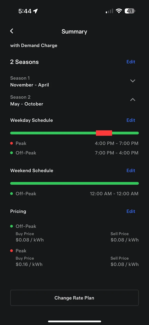

So, I think I’m doing that…
Does this look right to you?

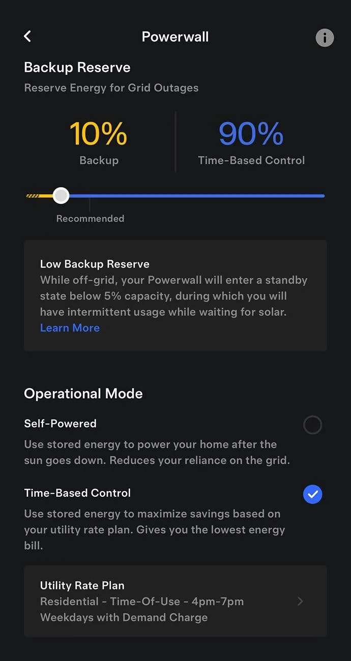

I have tried this with the backup reserve set higher too

It’s the “demand charge” part it doesn’t seem to grasp

It just says “demand charge”. Not otherwise specified. Not” tyrannical overbillling for five minutes of accidental use.”? seriously though, I don’t know how to see what it means by “demand charge”
That’s what gets you. Not the 16 cents per kWh

Yeah... peak mode should avoid pulling from the grid if at all possible. Everything in the house runs through the Gateway and both PW3 charge and discharge normally?

I *think* you can click edit and bump start time to 3:45. (Don't have a system to test on).

You’re right. Was very simple to edit. I made the peak hours 1500-2000 rather than 1600-1900 to see if it makes a difference
