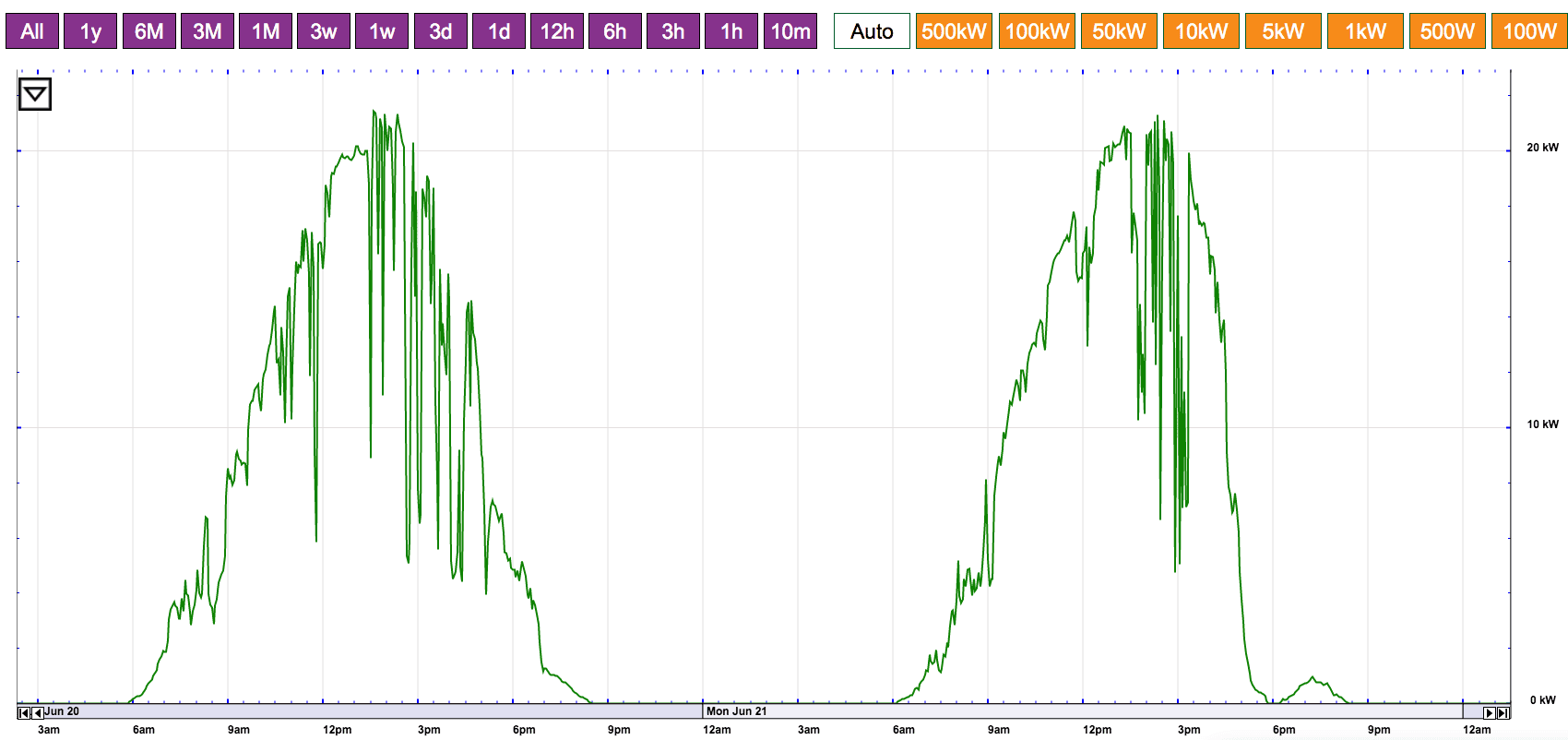

You can, as noted, charge a Tesla from nothing but solar arrays and an inverter. Here's another picture of a couple of days collection showing what clouds do.
Tesla Roadster 2nd gen Off grid solar eGauge3
It's plain from this picture that there are opportunities on either of these days to charge a Tesla, even at a high rate. You actually wouldn't have to do anything. You could start charging at 0945 on the 20th at a 10 kW rate. You'd be fine until around 11:45 when the car would shut down. But as long as the 240 is there it will try to start again. When it starts a charge it ramps up. I don't really know what happens if voltage starts to drop before it reaches the desired rate. I think it is doing this ramping to test the supply and so I think it will shut down again. But it will keep trying and after that cloud passes it will be able to draw the desired 10 kW with voltage in range and the charge will resume. On the 21st (the solstice) you'd be fine at 10 kW from 0900 to 1430. For daily use replacement charges these windows are probably sufficient. They are for me. This is actually how I charge (except that the utility would step in rather than the charge terminating if solar can't do the full 10 kW).

Yeah I am I know. I was saying that the CT should really have the option to plug PV in directly for off-grid use like yourself. Thats the options we've been trying to figure out here, on how best to go about it. :)

Assume about 2.5miles per kW per hour, but you're probably limited to what your 110V circuit is rated at, and whatever else is on that circuit. So maybe 5miles per hour max. It will take a while.
I'm offgrid with 30kW but that is 3phase 415V. Hopefully the CT will have some PV inputs that might help.
I do have 240v capability and when sun is shining seems like i have tons of extra juice. I also plan on adding hydro power supplement for winter (if it ever rains in California again). From what you all are saying i get the feeling I could manage an electric vehicle. Maybe some additions and tweaks and excuses to head out to super chargers! Can’t wait for my first tinder date picnic at a super charger!
