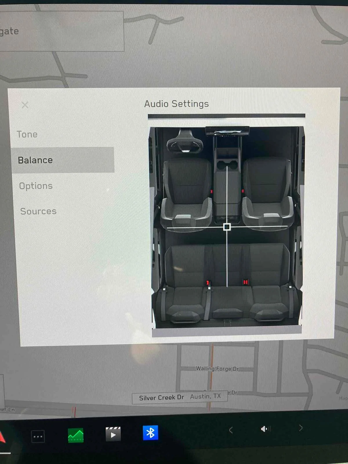

Did you check the sound-system balance/fader controls?

I tried this procedure just now. It look at least 30 seconds for the A/C and interior lights to shut off, and another minute before it "beeped" and the mirrors folded in.
I waited 5 minutes, screen, fan, etc. shut off. I don't recall if there was a beep or the mirrors folded. The Dome lights stayed on and ambient lights stayed on, which I have set to ON rather than Auto. I will try again. You stayed inside, right?
I used the balance to be sure the rears weren't working right. Full to the rear at 11 it sounds like a transistor radio from the 60s. :rolleyes:
