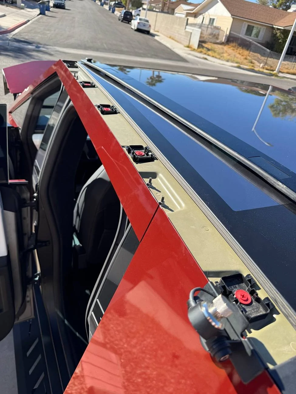

Here are my NMO mounts
Changed the cable to RG188 (pics show RG58) and snake it thru a gap in trim, then in to back door,
tucked into weather seal, under floor mat to radios in a box in the center below console
APRS and Voice radios in box with LiFePO batt from Bioenno.
15V USB-C PD cord with series Si diode and voltage is in the acceptable charge range.

The mounts are just two pieces of al angle. Holes in the bottom piece to match the
CT mount and a 3/4in hole for the NMO mount in the top piece.
Al angle must be thin or the normal NMO won't mount.
The two pieces were then pop riveted together at the correct
angle so the antenna ends up vertical.

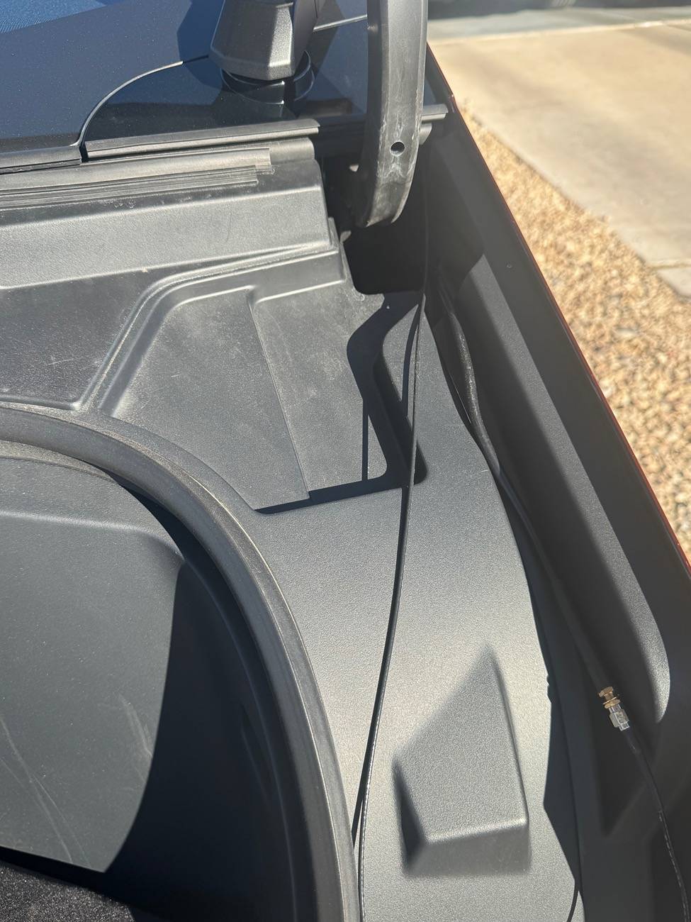

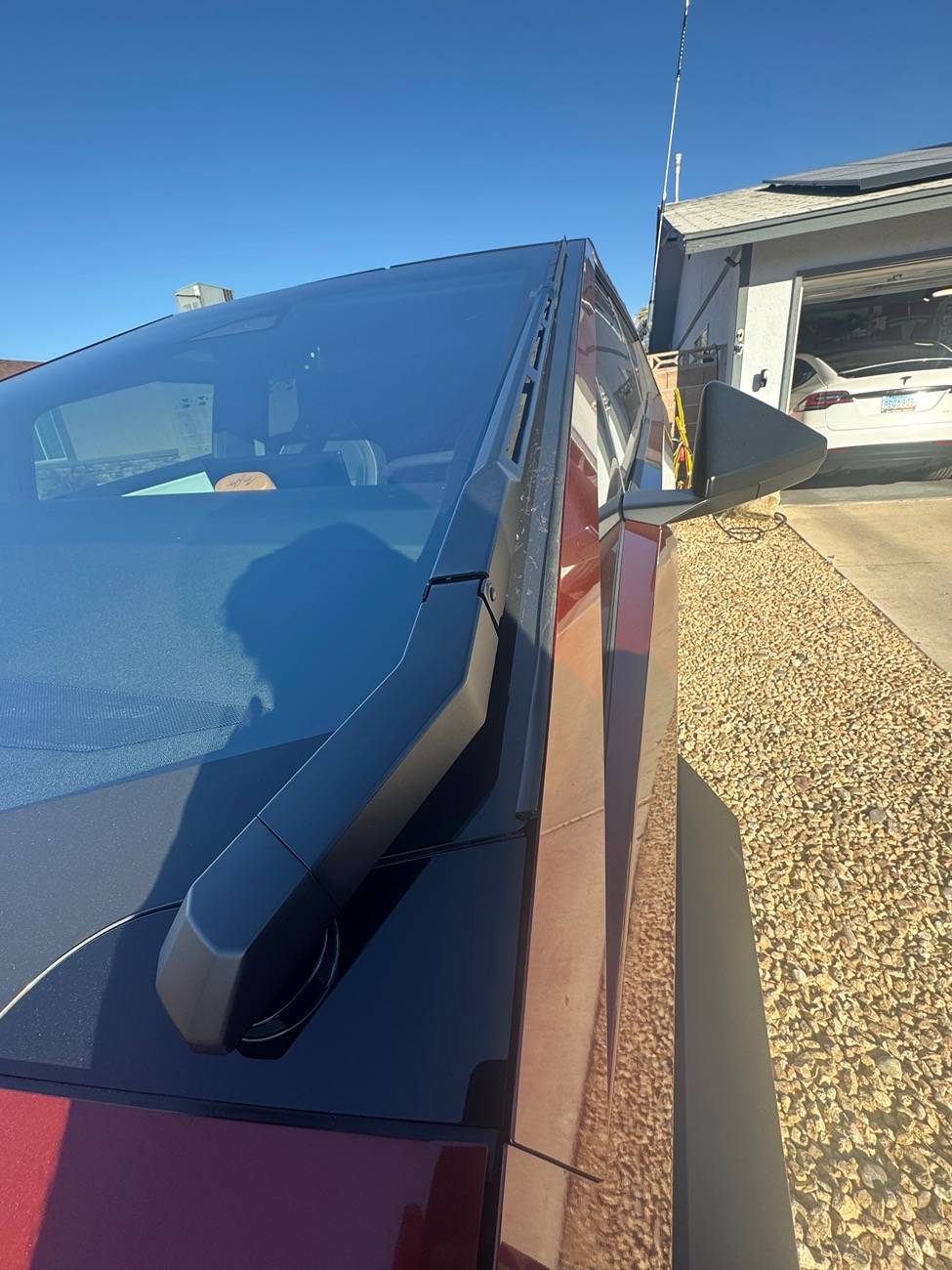

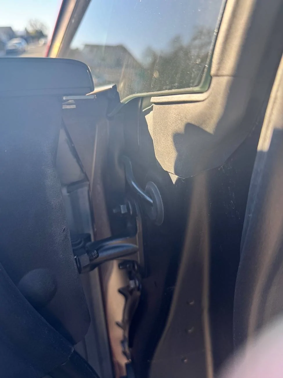

I figured out how to get in the cabin without going through the door seal.
1.) Mount Antenana behind the rear door at the back of the plastic roof trim. I used a trunk lip mount K400 from Diamond. Pop the trim off the roof line and run the cable inside the roof line.
2.) tuck the wire under the rubber trim on the windshield down to the bottom into the frunk.
3.) use wire fish tape to pull that wire back through the fender to the inside of the door jamb
4.) There is a grommet you can remove and cut a hole in to run the cable into the cabin inside the dashboard. From there you can do anywhere you want in the car. I ran my antenna cable between the top and bottom half of the dash and it comes out under the touch screen.

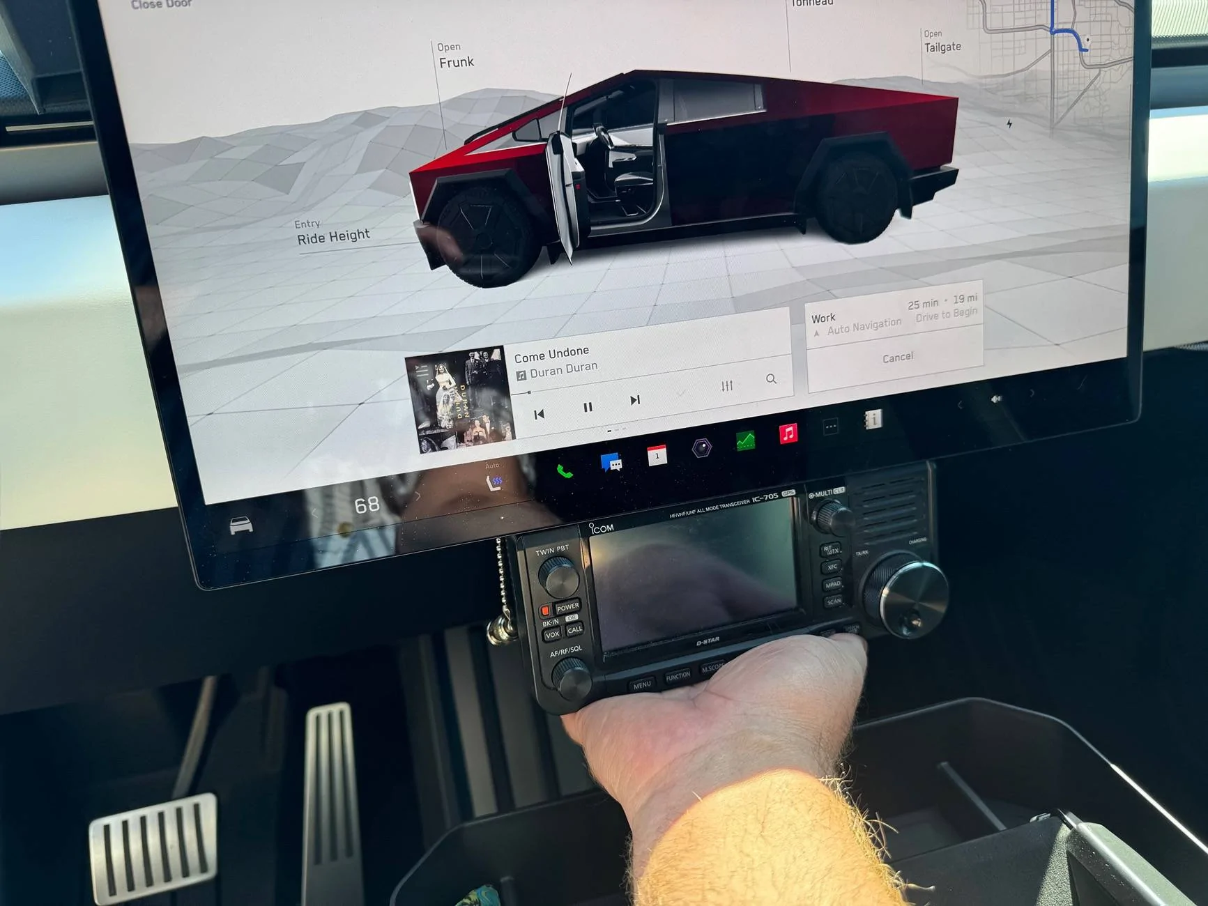

this is the one part I’m still working out. Here’s where I wanna mount the radio, and I have a friend of mine that fabricates parts that is gonna look at making a bracket for me that can wrap around the back of the screen and hold the radio in place underneath the touchscreen. I could use the tripod mount screw to hold it to the bracket so that’s why I routed the cable for the antenna and the termination of the Anderson power pole behind the screen. Plus it took two segments of cable to run all the wiring I need for the antenna so I have a spot in the front where I can disconnect the antenna and connect the radio in the frunk so if I wanted to set up with the radio up in the frunk area I could do that too.
