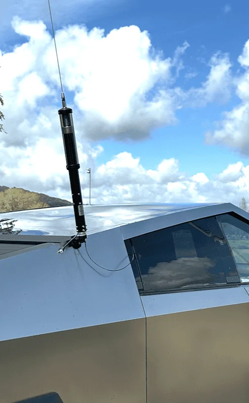

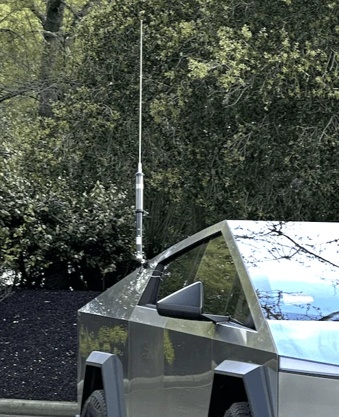

With just 1 watt I was able to reach Japan, China, Russia, Australia, Morocco, Spain and Denmark! Cybetruck makes the perfect ground plane for an antenna! Previous experiences with Model Y were not so good. Cybertruck is def. the quietest electric vehicle, RFI-wise.
I managed to install an HF and a VHF/UHF lip mount antennas on my Cybertruck by removing the aeroflap. Easy install. Still researching a way to route the coax in the cabin but my RG-316 cable just snakes easily through my rear door seal.
I used the Diamond KS-400 (heavy duty, 'super-gainer", lip mount), works like a charm, super stable. Select the 16ft coax option, 6ft is not enough. I used the 3/8x24 for HF and or UHFmounts for the rest.
Antenna: Little Tarheel (500watt capable) for 0-30Mhz, Comet for 144/440Mhz
Radio: IC-705, looking into installing an HF power amp as well.
Battery: floating battery for now, will try a USB-C 'trigger' for 15V, the IC-705 has no problem with 15V PSU, I used it before.
40m band --Not tested yet.
20m band -- S1-2 when truck stopped, S9 when in motion (not usable)
10/11m band -- S1-2 when stopped or in motion, almost no noise. CB radio (11m band) also works very well!.
144/440Mhz -- S1-2 clean, can be used in motion, no problem
NOTE: HVAC puts out a lot of noise on HF but not as much as on Model Y.
Here are some pictures, enjoy!
Ask me any question, I will be glad to help,
'73s

Thank you for showing us the way: Kindly advise how you got the mount set screws secured. Did you remove the upper applique? ("AIR VANE").. Could we have a close-up snap-shot. Greetings from W5-land!
ituner-HF
Andrei
Feb 1, 2021
47
162
222
Pleasanton, CA
Model Y, Cybertruck VIN 32xx
9'
I used a lip mount and yes, I removed the top aplique in order to fasten the screws, it's a bit ght but workable.
