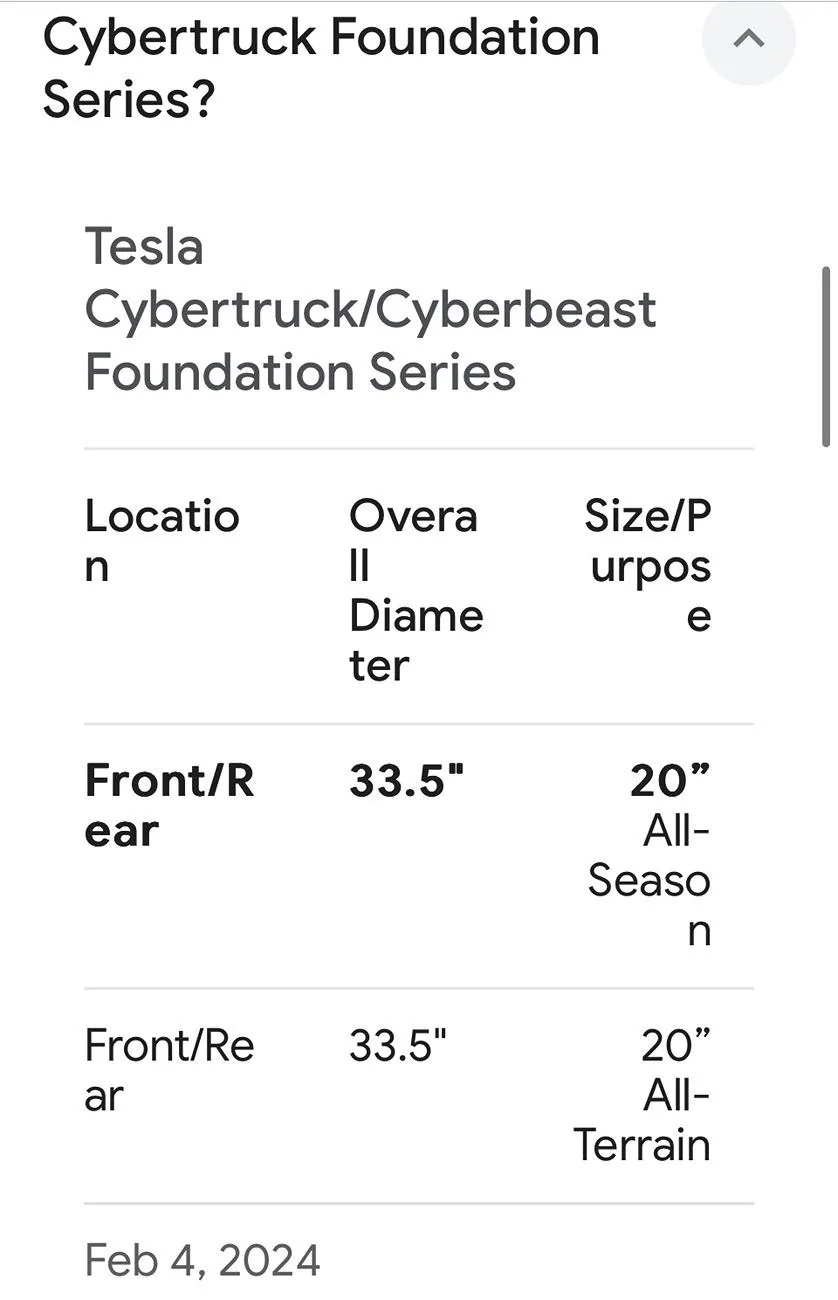

Just ordered my foundation and it states “35 tire “. But after looking around it seems to say the tire is Actualy 33.5?? Am I missing something? That 1.5” makes a difference to me. I like the extra hight and wheel well filled up. Why not say it comes with a 33” that would be more accurate ?

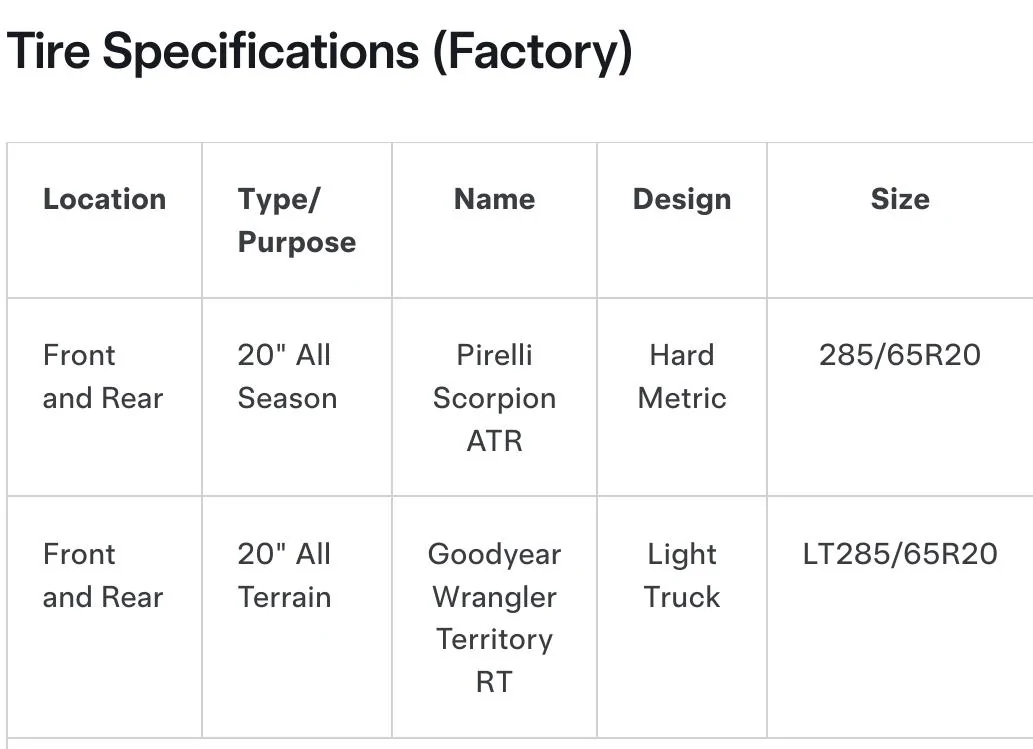

Tesla Roadster 2nd gen Foundation Series tire 33.5” or 35” Screenshot 2024-08-14 at 11.27.07
hmmm.. I found this, and it shows 34.6"
"285/65R20 tires have a diameter of 34.6" (878 mm), a tread width of 11.2" (285 mm), and a wheel diameter of 20" (508 mm)"

Well that would make me happier, I keep coming across this one that says 33.5. I know for the average joe that doesn’t care about that it isn’t a big deal but I’ve always had trucks with 35” and leveled or lifted and just think it looks so much tuffer so to speak with large tires and lifted up a little bit so I will take the extra inch . ? I’ve already been checking our ways to drive in high mode lol.
Ignore the erroneous data point
285×0.65÷25.4×2+20 = 34.6
