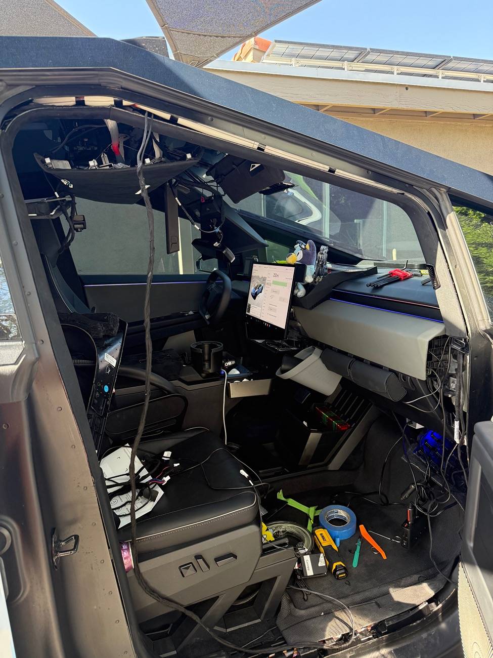

Update: So good news. I have the thing wired in and it appears to run without the code. The bad news is I still have to figure out how to wire in my tesstudio starlight roof without causing the same error. Also, my car looks like a developing nation revolution inside. I’ll have to fix that too.
It came with zero instructions so @CT_AZ_4x4 and I spent the afternoon yesterday reverse engineering to figure out what to do.
I’ll try take some good photos today so I can help others moving forward.
Tesstudio did send a couple of pictures and a video after I asked but they don’t show anything useful I think. Happy to share those too if anyone needs them.
Btw, as to this probably slightly intimidating image, if I had any instructions whatsoever like in this thread most of it would have been completely unnecessary.
