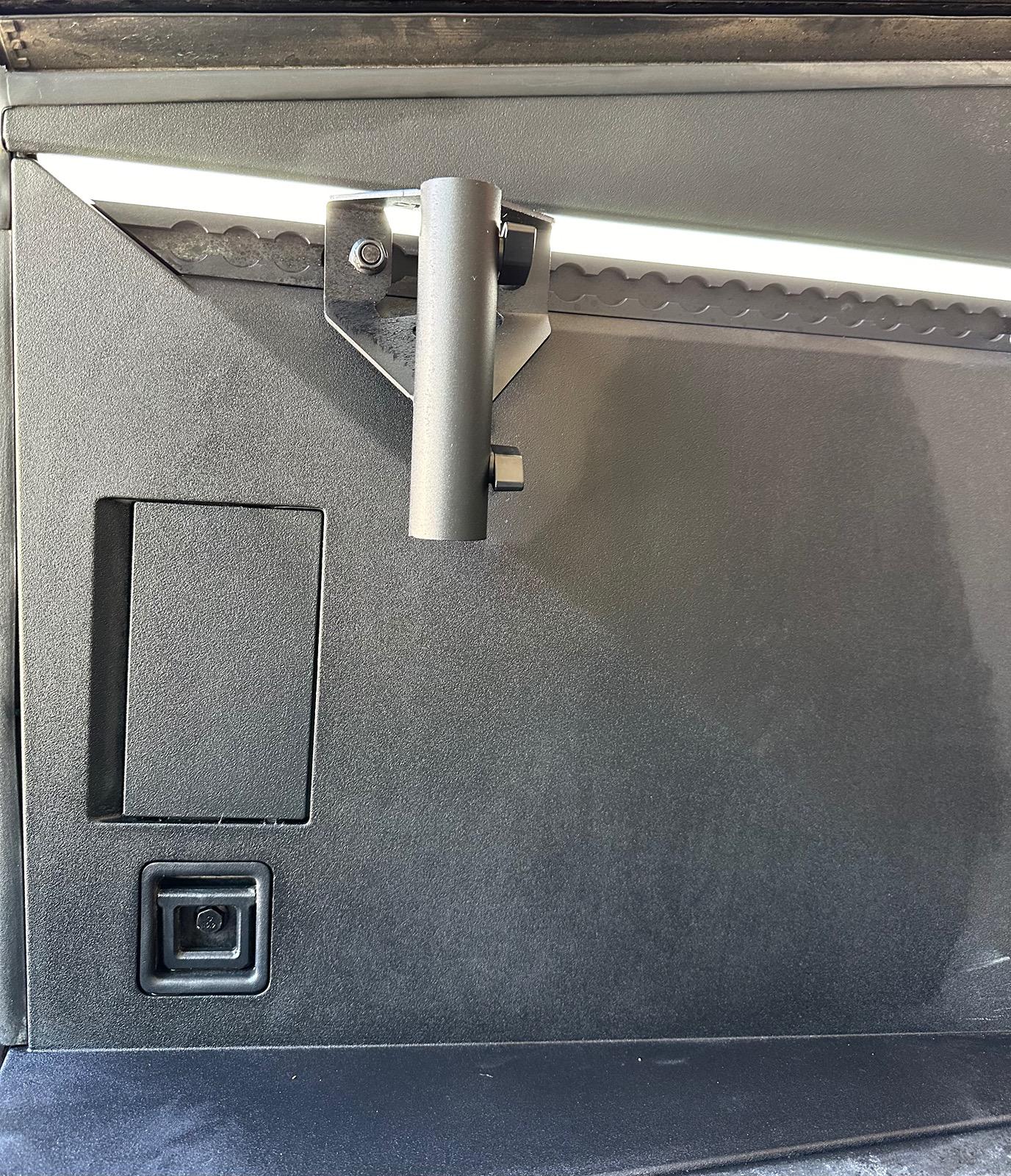

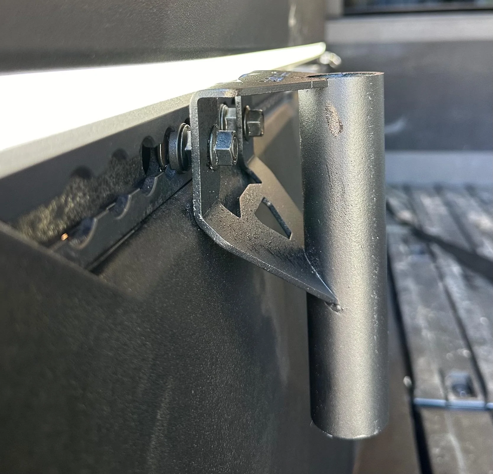

Hey All,
Wanted to install some sort of flag pole holder in the bed to fly my American flag on holidays. Couldn't find anything specifically for the Cybertruck, but found a mount that works with the L-Track. For $40 and a little modification, works great. It mounts solid, and can be left installed without any impact to the tonneau cover, bed outlets, etc.

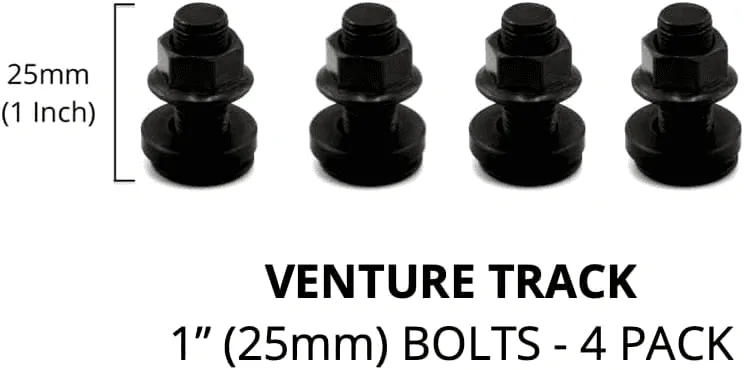

And these are the bolts I used to mount the flagpole holder to the L-Track:

And, due to the angle of the bed wall, I mounted the bolts, using the square washer and the supplied nut, then mounted the flag pole mount on top of those nuts, and used a second set of nuts to secure the flagpole mount to the L-Track bolts. This provides enough offset so the mount in vertical and the flag pole can be installed with the bottom of the bed floor.

Someone will surely improve on my design, but this works!
