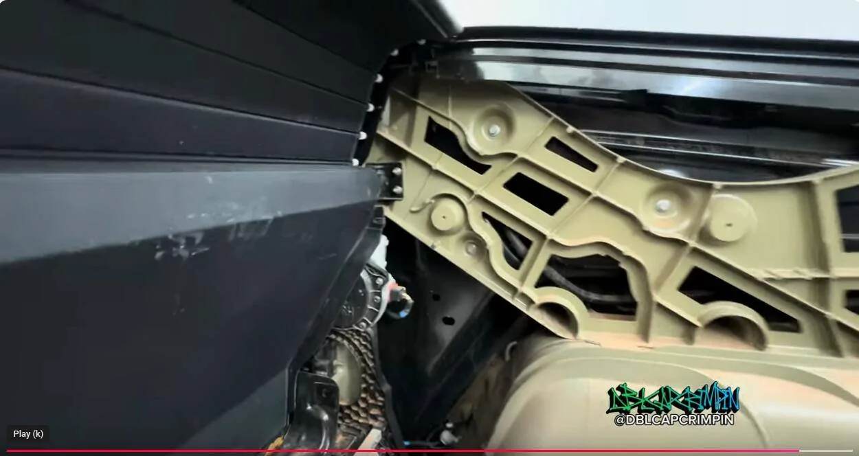

I'm now thinking that I'll fish wire under the rooftop applique and drill a hole in the sidewall for a bulkhead DC power socket. There appears to be plenty of room in the sail panel, if you can avoid hitting the casting.
Tesla Roadster 2nd gen Finding always-on 48v in the cabin or bed DC Power Jack
Tesla Roadster 2nd gen Finding always-on 48v in the cabin or bed SailCavity
Screengrab from youtube, @Dblcapcrimpin
https://www.youtube.com/watch?v=u7f5fvEahKs&t=196s
Only problem is removing the whole sidewall like that is a bitch and a half. The upper sidewall is easy, but you are highly likely to break the clips, which are made of some sort of cake.
I'd give it a shot without removing any sidewall at all.
