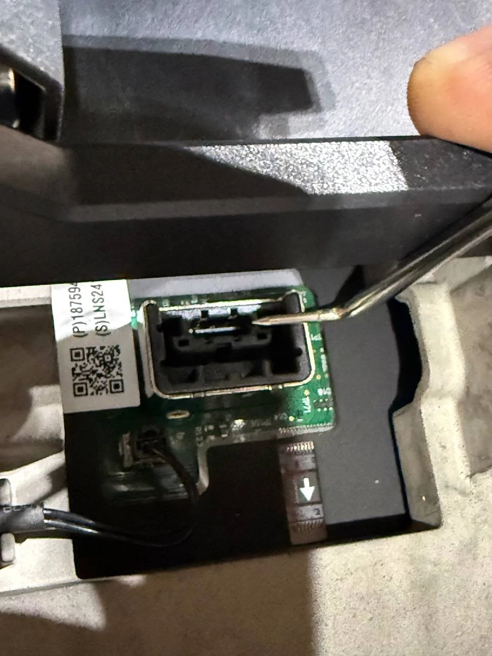

My install failed. The USB-C port is almost directly in line with the mounting bracket. All the install videos I see mention it’s close, but this is not close. It’s straight up in line with it. Did Tesla make a change? I also noticed that the bolts holding in the OEM screen are not hex sockets, meaning you cannot use the Allen wrench to take them out only a 10 mm wrench.
This also means you cannot use the factory bolts as instructed to reinstall as the new plastic doesn’t have relief for the socket.
I mounted the bracket and place the pick perpendicular to the surface showing the plane.
Tesla Roadster 2nd gen Failed screen tilt install - USB-C interference IMG_2186
I saw another post somewhere that ran into a similar issue and had to use washers to do the offset and trim plastic pieces. I’m not gonna do that.
Tesla Roadster 2nd gen Failed screen tilt install - USB-C interference IMG_2185

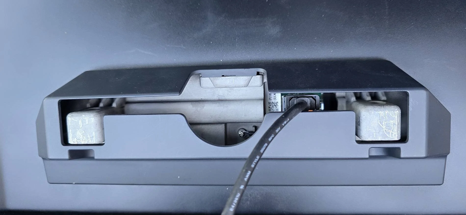

I don’t recall any issue with the bolts (6000s vin, so maybe that changed but they were still hex and I was able to tighten them without washers).
The length was tough. The instructions used the zip tie to try and secure the connection. I decided to forgo the zip tie and used electrical tape to secure the extension cable. That gave a bit more play in the cable and made it easier to install.
Tesla Roadster 2nd gen Failed screen tilt install - USB-C interference IMG_0614
Edit: just remembered and saw in the picture, the socket screws have to be used for the screen side. That might be your issue.

Thanks for the pics. There is definitely too much interference to seat the right mount in your picture. Your bolts are definitely different than mine.
This is a good pic of how much in plane interference there is.
Tesla Roadster 2nd gen Failed screen tilt install - USB-C interference IMG_2184

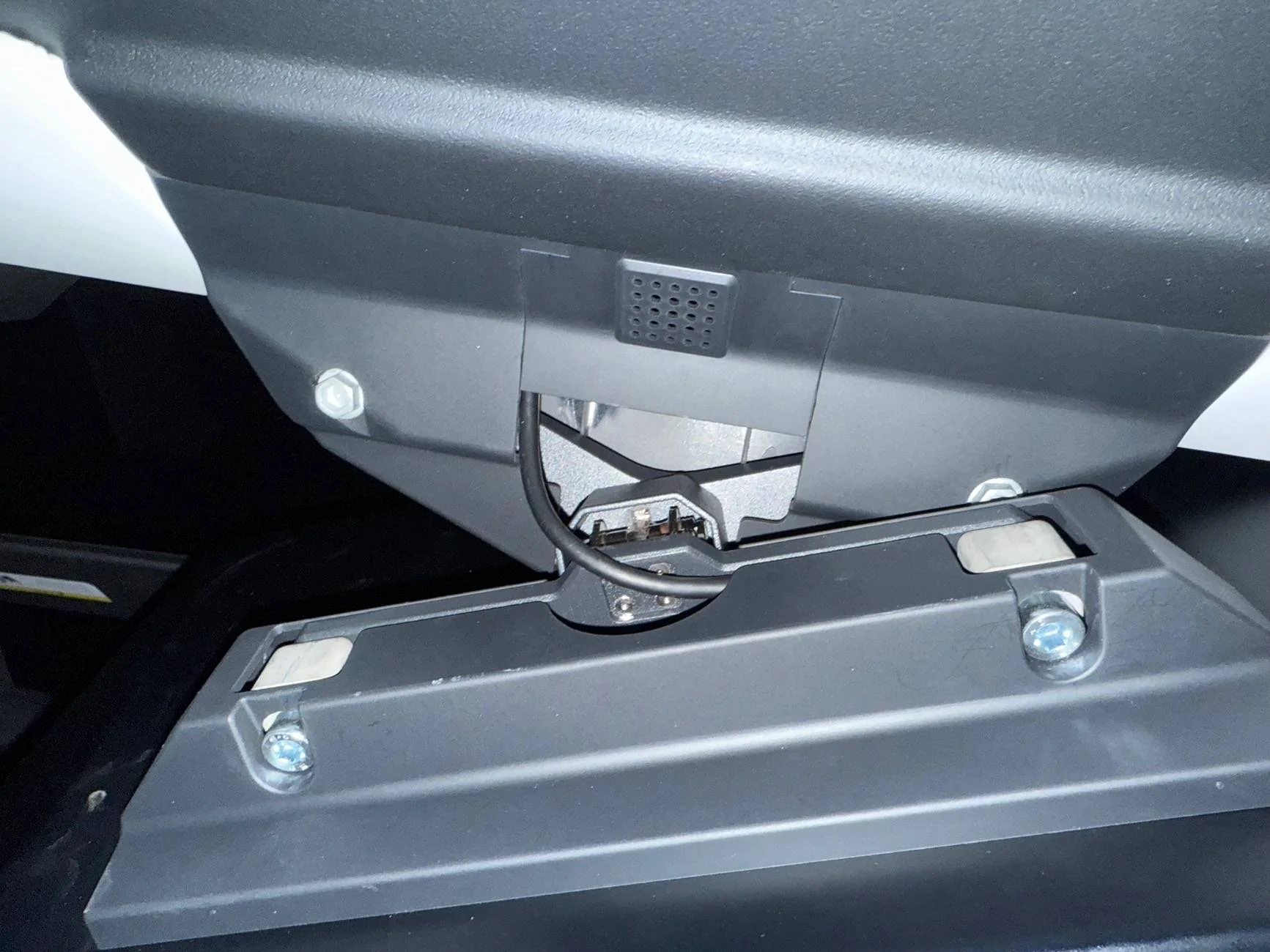

The attachment bar should slide over the USB plug. It’s a tight fit. I have vin 27xxxx and the bolts were not hex. I believe one manufacturer provisions all. I could be wrong.
Tesla Roadster 2nd gen Failed screen tilt install - USB-C interference IMG_2108

I'm having the same issue with the bracket from Hansshow.
I've used a plastic spacer and a washer to get the bar away just far enough from interfering with the plug but that moves the screen lower by another 3/8" or so. The the rear cover of the screen won't fit with these spacers in place either but at least it's installed and works.
I've sent pictures to Hansshow today and will update this once they reply.
The USB plug is clearly in the way of where the bar goes. It's a bit blurry in the background but you can see how the usb plug now just fits below the bar.
I know it's a rusty bolt but It's all I could find at the moment. I'll replace it with a stainless bolt of course :)
I hope this helps someone.

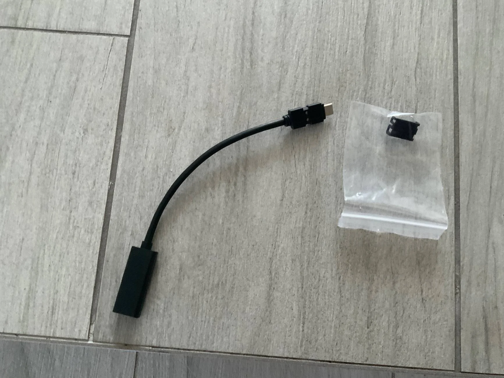

Thanks for your reply. Yes. That secure latch design works fine and also avoids plugging the extension in the wrong way. The problem is the male end that connects to the screen. By the time the safety clip that interfaces with the motherboard socket of the screen is attached to it, it becomes too fat and too long. One can plug in the supplied extension without that safety clip but it would still bend the USB connection uncomfortably as its a very tall plug and will likely wiggle loose over time, not to mention possibly break the PCB.
That male end needs to be a 90 deg plug design that can be secured to the mother board's special usb safety clip.
Tesla Roadster 2nd gen Failed screen tilt install - USB-C interference 90 deg usb adapter
