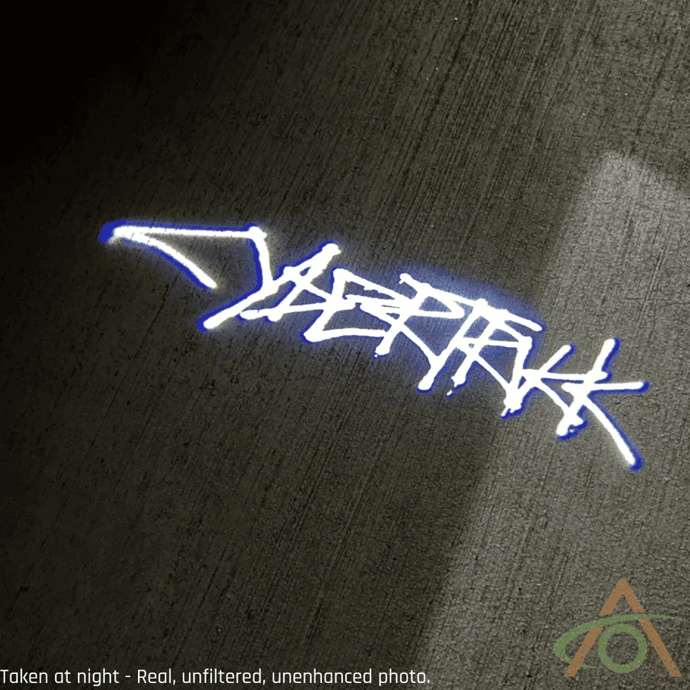

  3. Projection lights in the doors, so far, have been a complete failure. This includes Tesla's own "TESLA" projection light they sell in China. The Cybertruck projection shown up thread was taken in a Highland, on the basis they use the same factory bulbs, but turns out that assumption wasn't a good one. Version 14 is due in the mail tomorrow to try {sigh}

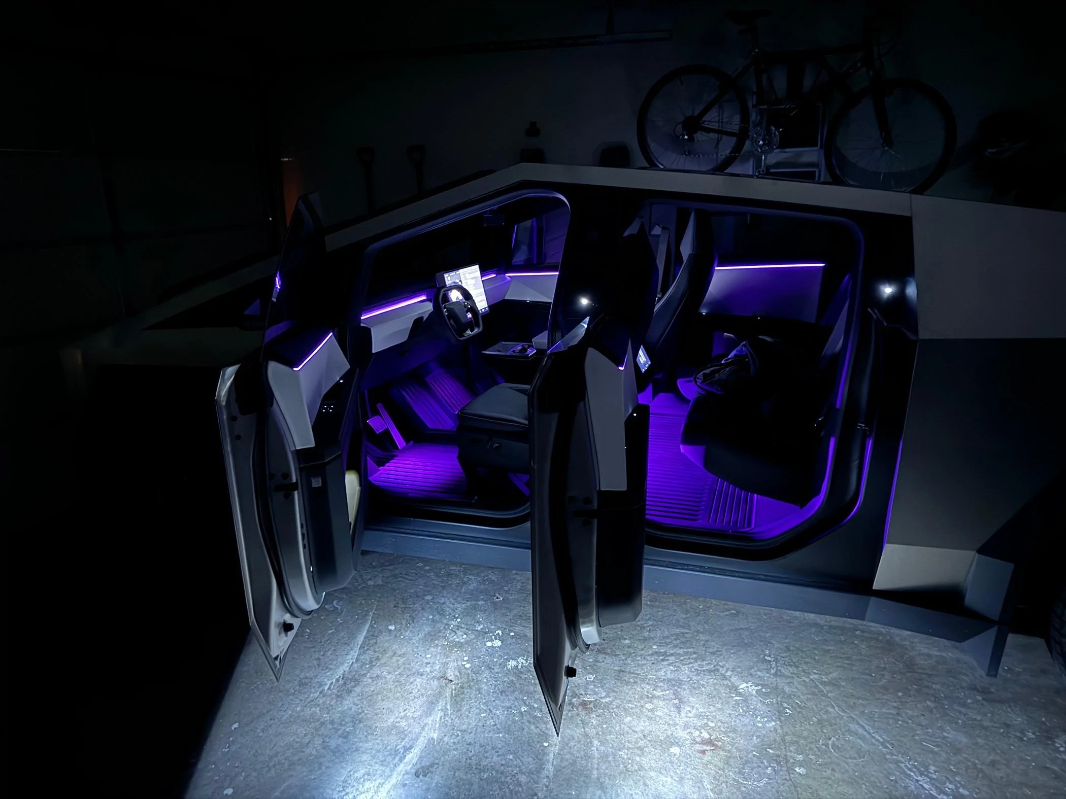

Just finished installing all 10 of these lights. Overall the install is not difficult if you've worked on cars before and aren't shy about removing trim.
Overall 5 stars! Thx @AO-Pete!! Here are my installation notes to help make your install smoother:
  1. Watch @AO-Pete 's video on how to install, it helps.
  2. Do the rear light under the driver's seat before the one under passenger seat! It doesn't get hung up as much or at all on the center console and gives you a better feel for what it should do when you open up the trim box thing to get at it. The one under the passenger seat can get hung up and is a bit annoying.
  3. Under door lights clicked, they're in! NOT! Double check, triple check. They kept fooling me. Simple, but they're deceptive.
  4. The light in the driver's foot well is in a very fragile frame. I didn't break it, but I had the right tool to compress and remove these lights. If you're using a flat blade spudger thing, you risk breaking the mount point, I highly recommend just cutting the clips off the old light with some wire cutters just to be safe.
Fun effect, fun install.
Oh! If anyone wants 10 intact stock CT ambient lights, let me know!

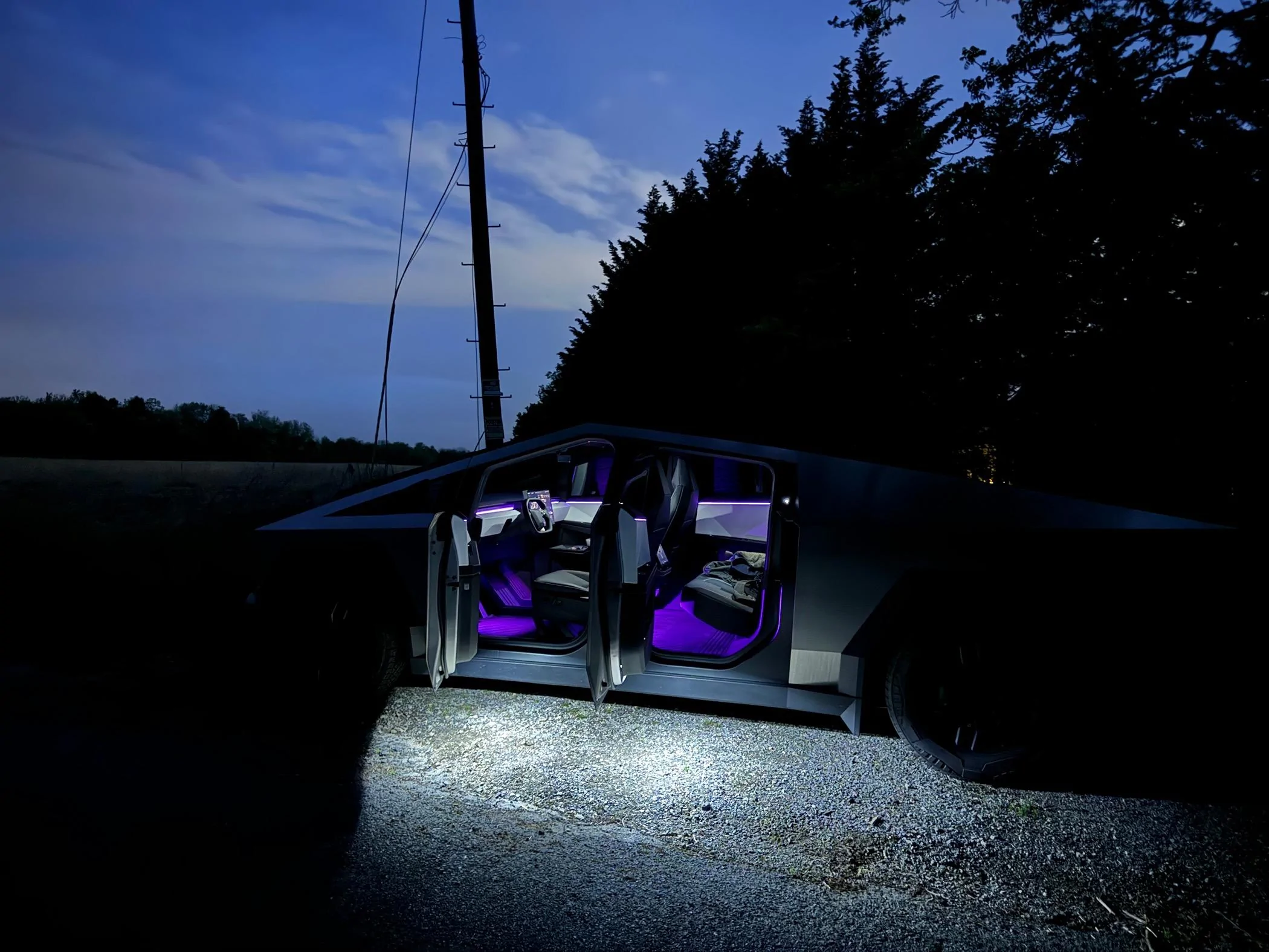

3 Month follow-up:
Still working perfectly and I still LOVE the way these look at night. Get compliments every I'm out and someone sees me open the door and the interior lights up purple!
The ONLY 'issue' I've had is every once in a while I get a slight blinking (more of a pulsing, doesn't turn off) of the driver's front under dash light right when I first get in. It stops after about 10 seconds, and never happens while driving. Other than that, 10/10 with an extra point for their amazing customer service!
11/10 would recommend.
