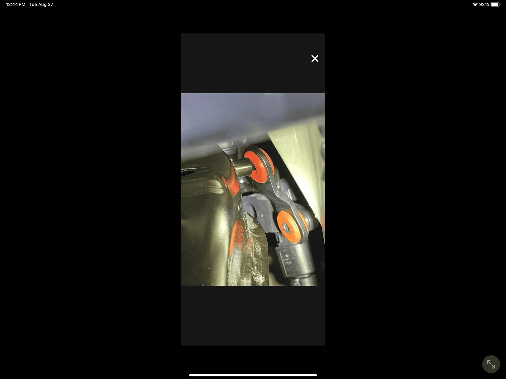

Up above, I was one of the guys saying how much I loved the Lift Rod KIt. Well, I’m amending my post and I wonder if anyone else has an issue.
Yesterday my back end collapsed like there was an air tank issue. Took it to Tesla and the tech said the aftermarket piece I’d installed didn’t “sit” properly and became dislodged. He put it back on, took it for a test drive, and it popped right off again.
So it appears at least on mine that as the piece wears - because it doesn’t have “pop on cap” like the original Tesla piece - it will eventually wear enough and come loose.
Curious if anyone else has a similar issue? I wonder for those of you that have installed them if you want to crawl under your back tire and take a look if yours looks like mine and is close to popping out?
I’m not mechanically smart enough to know if this is a design issue or just something unique to my CT but I’m sharing here in case it helps others. It would be most interesting if another owner who installed the pars would look and see if there lift rod is about to slip off just like mine. Thanks!

I’ve been using this lift kit system from @CYBERTRUCKco for a month. I did have one rear wheel come loose, but I had installed it incorrectly. After following the pro tip video here, I was able to get the rear in perfect alignment.
