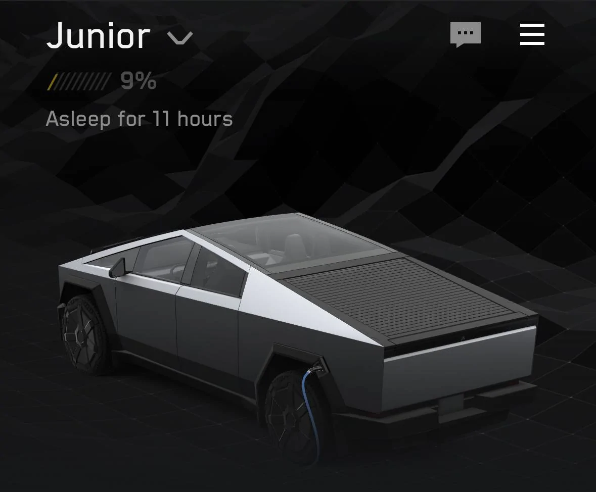

Try playing a lullaby.
8,533
10,728
Mine has slept for 18 days now, lost 7%.
