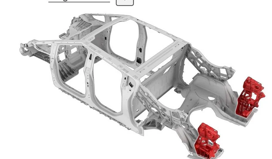

The castings and cabin inner/outer are the main structure. Of the body panels, only the sail panels have any notable structural addition.
The stainless on the doors is the crash barrier, but that's not vehicle stiffness/ main structure.

So you think a diagram with a component shown in red qualifies you to know how all the forces in the Cybertruck, through all its compenents, interact with each other?
Show a detailed 3D model rendered in RISA 3D or other structural design software (I am sure Tesla uses software way more advanced) and maybe it will be worth some consideration.
But looking at diagrams of how the Cybertruck is put togther and "guessing" how loads are distributed everywhere, under all concievable loading circumstances, is futile. It is way too complicated to guess at it. I don't care if you're a SpaceX rocket scientist. You can't know. (BTW a SpaceX rocket scientist would be too wise to even attempt a guess at it).
The AI summary said 60-80% was from the skin "primary". That's just plain wrong.
The image is the frame. The red just happens to be the sub page I was on. Look at the shock towers and the structure compared with load path.
To provide additional structure, the panels need to be structurally fastened to the frane. Only the rear sail is and only it spans two non-contiguous components (still outside the main load paths). Tesla stated the stainless increases torsional stiffness and helps with crash loads, that's about it.
OK, we are getting sidetracked on a strawman argument here. I dont know, and don't care, if the exoskeleton (or whatever you want to call it, the SS exterior) contributes significantly, mildy, or not at all to the loads express at the hitch.
My point is that only Tesla is qualified to know. They likely tested and failed every single component in the Cybertruck as that is how you earn a #1 ranking in crash tests (I know this is not a crash test issue....this is just an example at the excellence Tesla engineers have historically shown in their designing efforts). The high quality SS "shell" was just another example at the high quality materials they used.
Yes, I know there have been other issues with some Cybertrucks, like the top piece by the roof, and there have been some recalls...they aren't perfect. BTW: I have had no issues with my Cybertruck, and no recalls.
Could the hitch issue be a design problem? Possibly, but until trailers start flying off in significant numbers of Cybertrucks in the wild, and a recall is made, I am not sweating it based upon a Youtube video where creators are incentivised to cause controversy, which in turn creates more views, which makes them more money. That is their business model.
Others have already done an excellent job of explaining where you are wrong, (and why Grok, and other "AI" summaries are just aggregators and not the final word on anything), but I think the above bolded section says it all.
For my part I will admit that saying the side panels contribute "nothing" was an exaggeration. "Minimal" would have been more accurate, just like the body panels on any unibody vehicle contribute "something" to the structure. That doesn't make it an exoskeleton.
I think the side panels are actually a critical path for trailer and bed loads. The audio leads me to think the casting didn't fail until the spot welds to the towers sheared, and the only other load path for the towers is the sail panels. Without the sail panels, there is no reason for the welds to fail.

When you say "sail panels" do you mean the entire bed sides, since I assume they are one piece?
Yeah, the outer stainless + carrier bracket assembly that has four bolts each into the mast and tower castings along with more bolts into the C pillar.

I think the intent was to say that other elements may not have been stressed to the point of damage yet may contribute to the load capacity of the hitch/ casting.
I tend to agree and think the C pillar/mast -> sail -> tower -> casting is an important load path.
