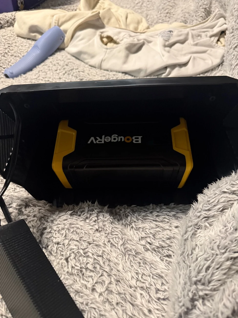

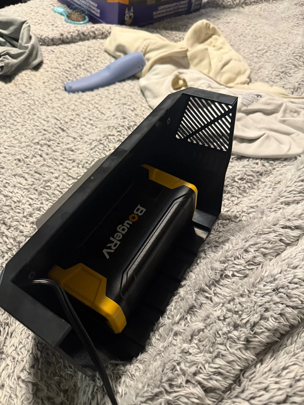

My most recent approach is this little battery from bouge rv.
https://a.co/d/dnTYdWu
It fits nicely in the space previously allocated for the ac to dc power brick. Ultimately I scratched the cover housing for access and probably slightly better ventilation because you can’t see it anyway unless you pull the seat all the way back.
So….battery but with zero footprint in the cabin or frunk.

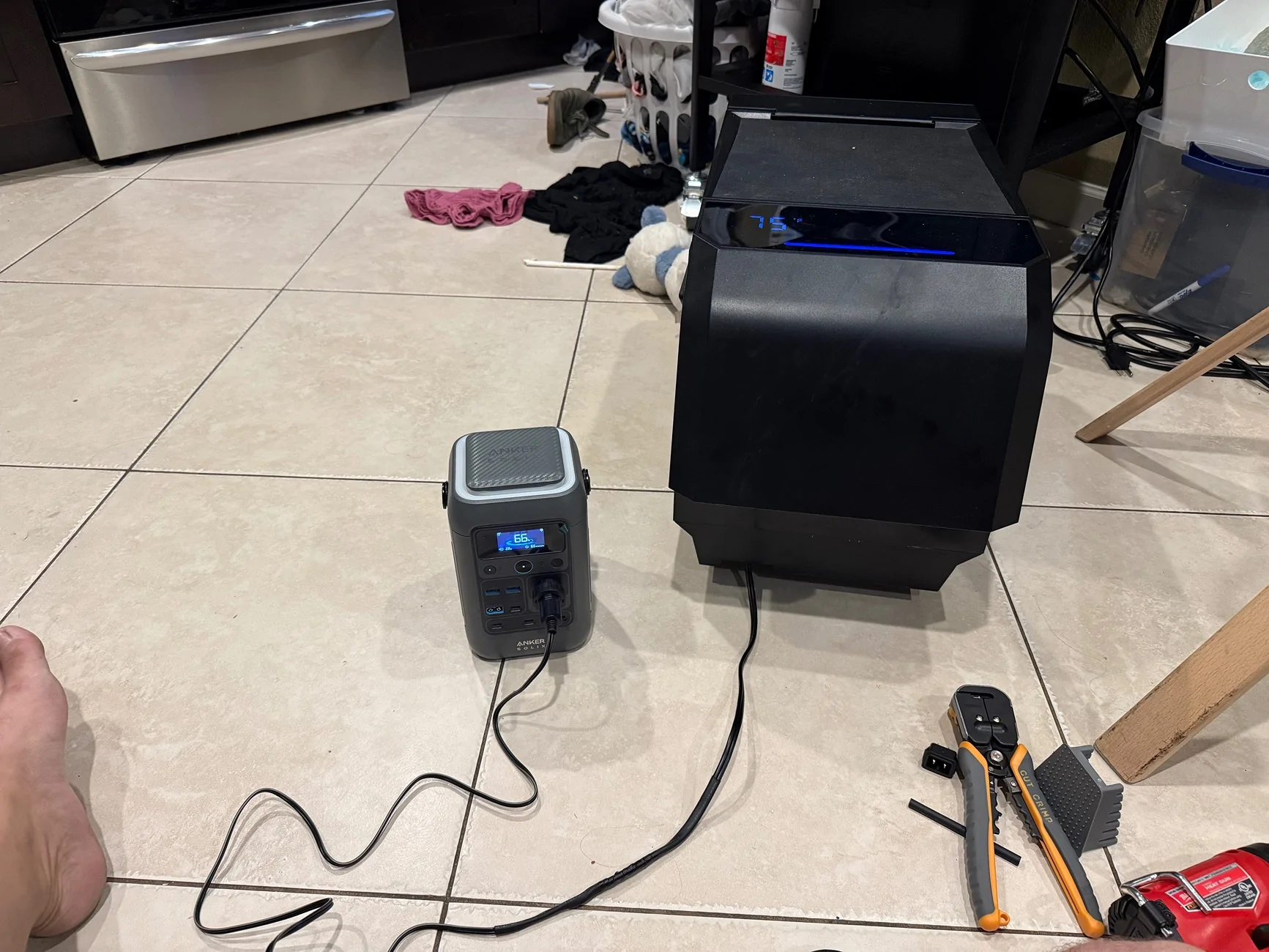

I agree that the little Anker c300dc is also an excellent choice for this application. I think there is now a little “me too” product from Ecoflow also.

Just read back on the posts and realized the prior suggestion was for a slightly different but very similar Anker. This one does not have the ac plugs so is probably inferior for the frunk application.

Some sharp observations. I had the same concerns. That’s why I ended up scratching the plastic housing despite the nice fit. All the controls and plug for the battery are on one end of it which gives you access if you slide the seat back.
Without the plastic cover there is at least an inch and a half or more on every side of the battery in that space. Other than the floor of course, but that’s true anywhere you put that battery. The center footwell or fridge tunnel if you will is not carpeted which is also a plus.
Temps have been non-worrisome so far even in Phoenix. I do generally keep my cabin overheat protection on in my climate, but I think you could safely turn it off in a more moderate place.

Thank u. Putting in my order now. How is the battery secured? Have pics by chance?
6,512
4,752
Will shoot some pics for you when I’m done with my shift. Velcro is what I did.
Three pieces of loop in the recessed grooves between the “stripes” and a single piece of hook on the bottom of the battery. Not even sure this is necessary because it’s pretty caged in there so there is zero risk of it going anywhere to have a drink or meet ladies, but I wanted it not to get knocked around.
After about a week of using it, I added my usb hub right on top of it too so it’s confined from moving upwards as well.
In other words, the Velcro was probably overkill.
I probably could have used a little piece of nano tape and called it a day or even not secured it at all.
