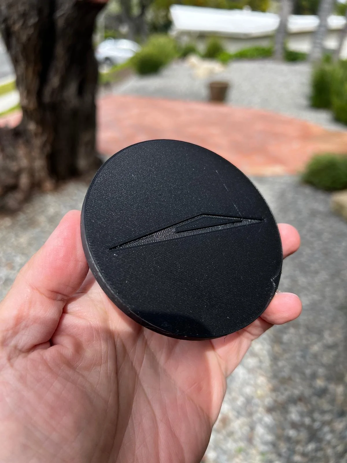

How has the PLA stood up to weather and temp? I just ordered a spool of recommended ASA, but might try the PLA since I'm waiting...
Just printed it with PLA (0.20mm, 50% infill) fits perfectly! Looks so much better now.

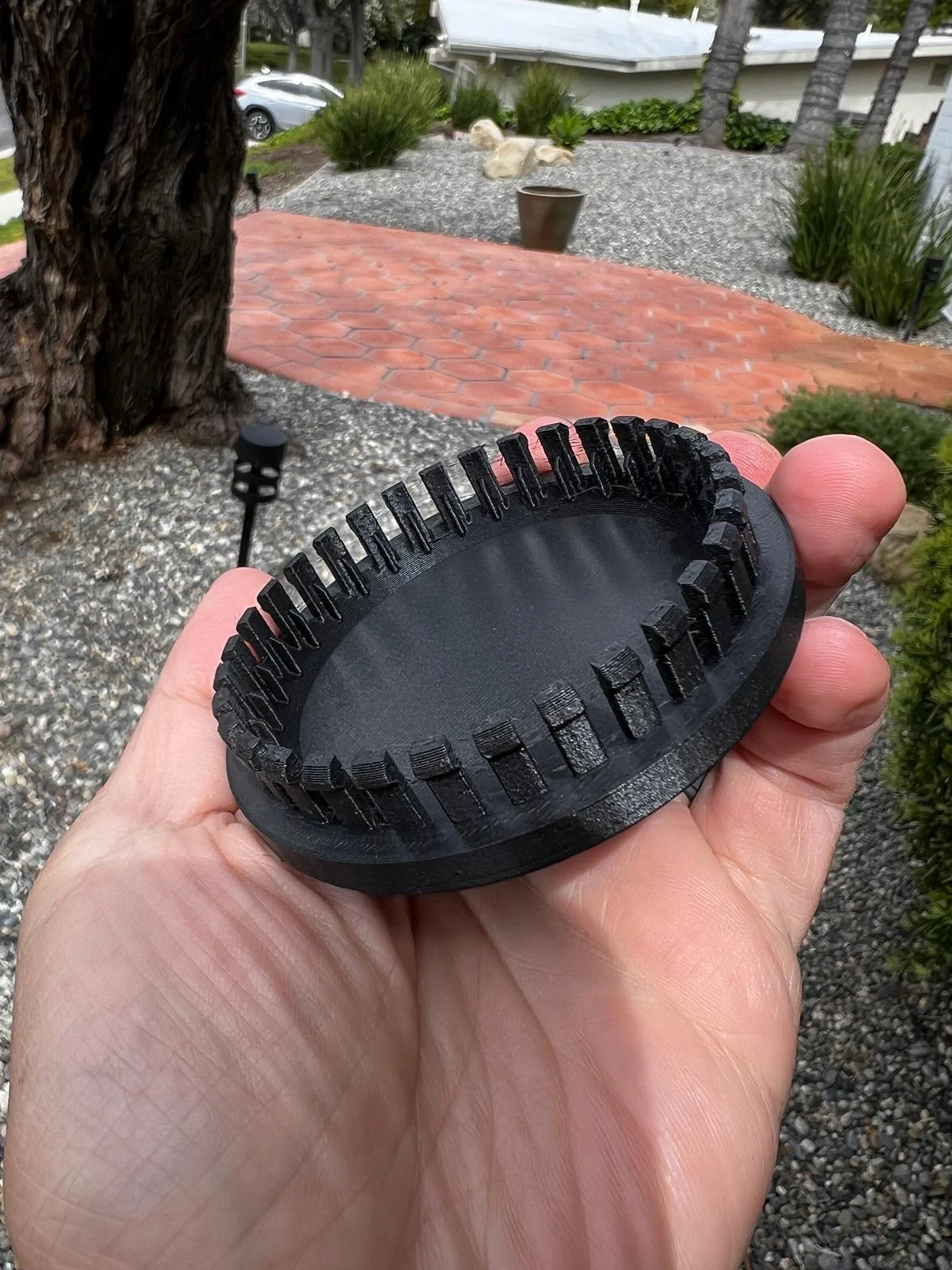

Actually, already lost one. And was able to pull the other 3 off with my fingernails.
Need to revisit... maybe print something slightly larger? Or different material. Or just buy one on Amazon...
