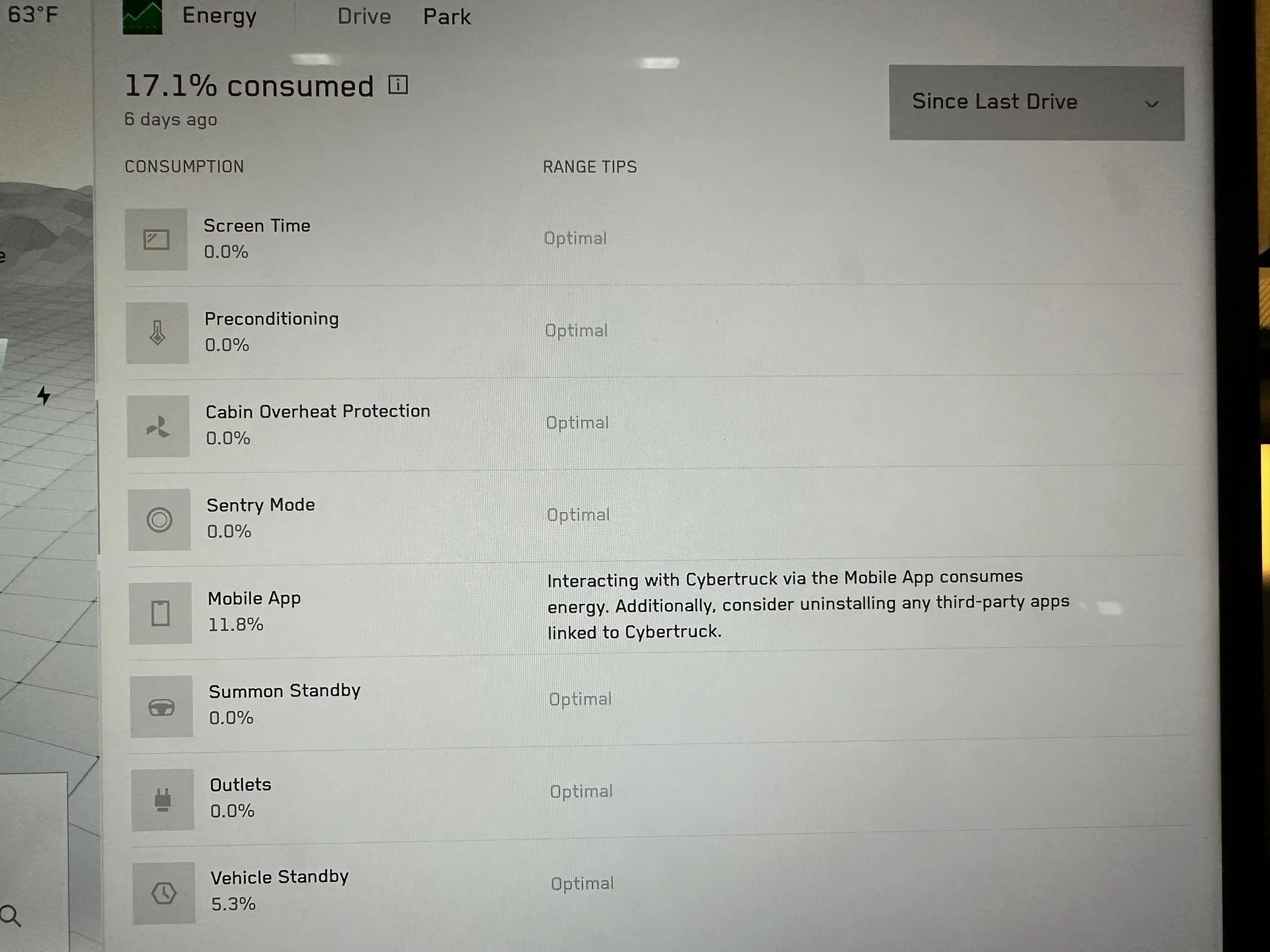

yclod
Richard
Mar 12, 2024
Seattle
Tesla Roadster 2nd gen CT Power loss in parking IMG_5268
i just checked the Energy app on the Cybertruck, it shows 11.8% power were consumed by the Mobile App, and 5.3% for Vehicle Standby.
I don’t think I interacted with the Cybertruck via my phone app while I was stay in a national park where mostly no internet for 5 days, I probably only checked the app once when I was in restaurant for no longer than 1 mins. (I am using iPhone. And no third party apps installed to Cybertruck)
the number of the power it consumed looks ridiculous
