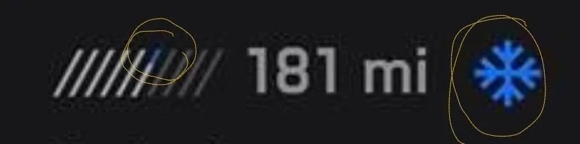

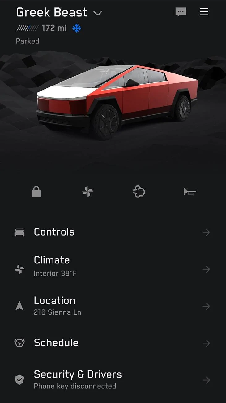

Does this happen to you?
I was 181 miles at 10:30pm and the next day at 8:30am my CT showed 172. Sentry mode is turned off when I am at home. I lost 9 miles overnight. Is this normal?

Yes. This is normal behavior on all electric cars, not just the Cybertruck. It’s wintertime, so you’re seeing thermal management. A big hint is that snowflake!

The pack is cold and is really at 60%
Blue bars is energy not currently available due to cell temperature.
Tesla Roadster 2nd gen CT loses electric miles overnight (vampire drain) Screenshot_20241209_091345_Firefox
2% = around 7 miles
9 miles = around 3% additional cold loss

No it's how li-ion cells work. There's actually different kWh capacities for warm and cold temps.
2% = around 7 miles

Yes, completely normal, especially in the cold.

Could just be adjusting to the temp. Observe %, instead of miles.

I guess I used the wrong nomenclature. Beyond the physics, isn’t the car also managing this situation which is what I meant?
The snowflake is letting you know what’s going on and isn’t that an indication that the capacity has been reduced? Then the car reduces regen etc. until the battery is warm enough?

Yes, the entire vehicle would also expend more energy preconditioning. I don't know if it would expend much overnight, specifically. But the snowflake represents how less efficient the battery is at giving you electrons since the chemical reactions it depends upon are less efficient in the cold.
If the outside temperature warmed up the pack, you'd see that blue part 'magically' return without having to charge the battery.
