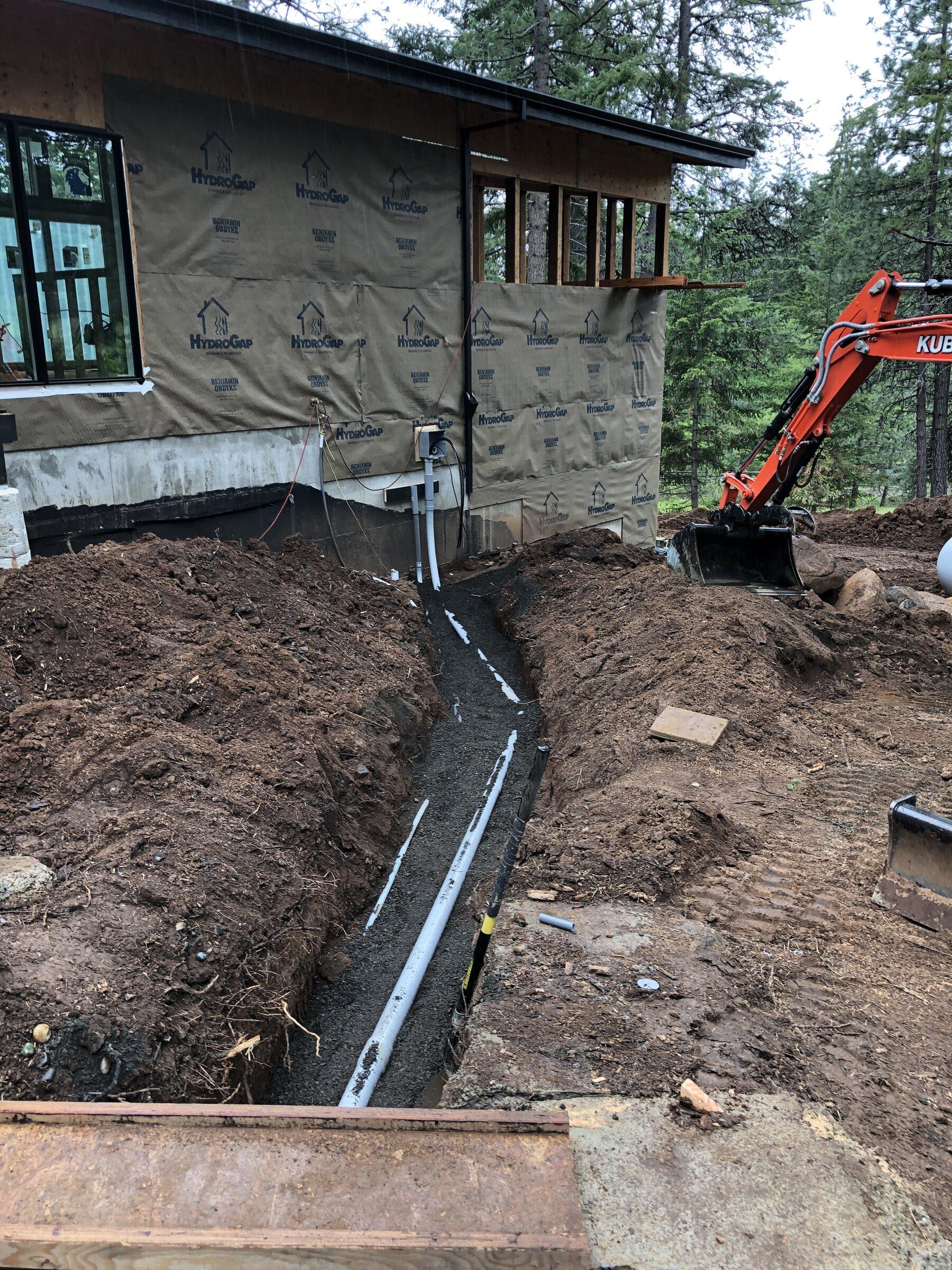

AWG 100amp. 4" conduit and aluminum 4 awg is the only way to go. If you don't need it, it still carries current below amperage rating. A life lesson that has payed off several times.

I guess I'd go with a 100 A sub panel which means AWG 3 or maybe AWG 2 if the run is long (or maybe even if it isn't). And stay away from aluminum. Yes, I know, I know, it's fine if properly terminated and coated and... but aluminum is a much more reactive metal than copper and in the ground.... But be sure you are sitting down when your electrician quotes you the price for Cu.
