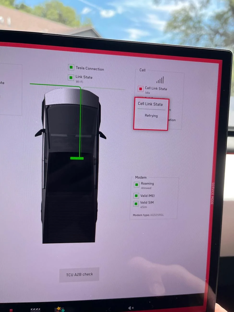

I have the same issue longer road trip 8 hours of driving and on the way back LTE died.
This is what the service mode shows:
