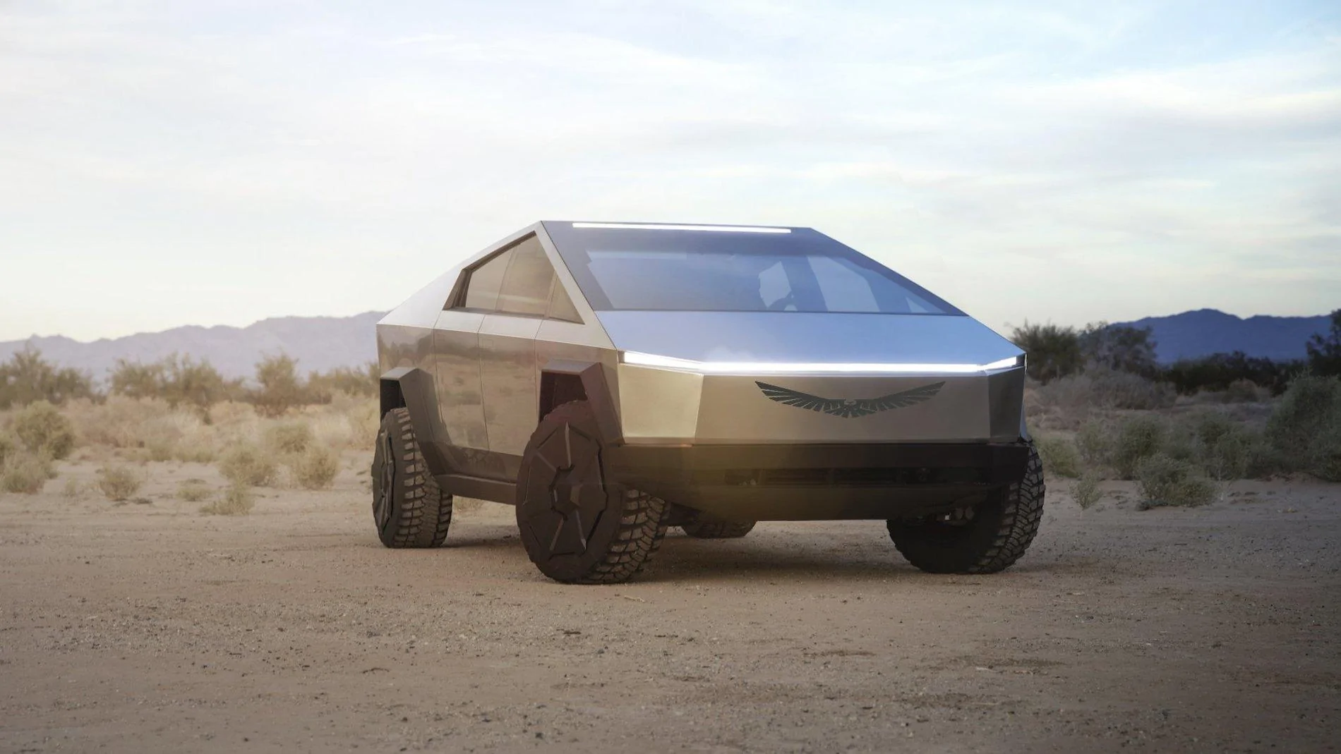

I was playing around awhile back with a cyber eagle design. After seeing your avatar I thought you might like it.
