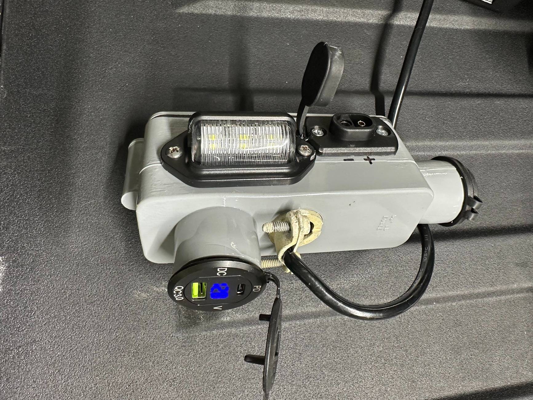

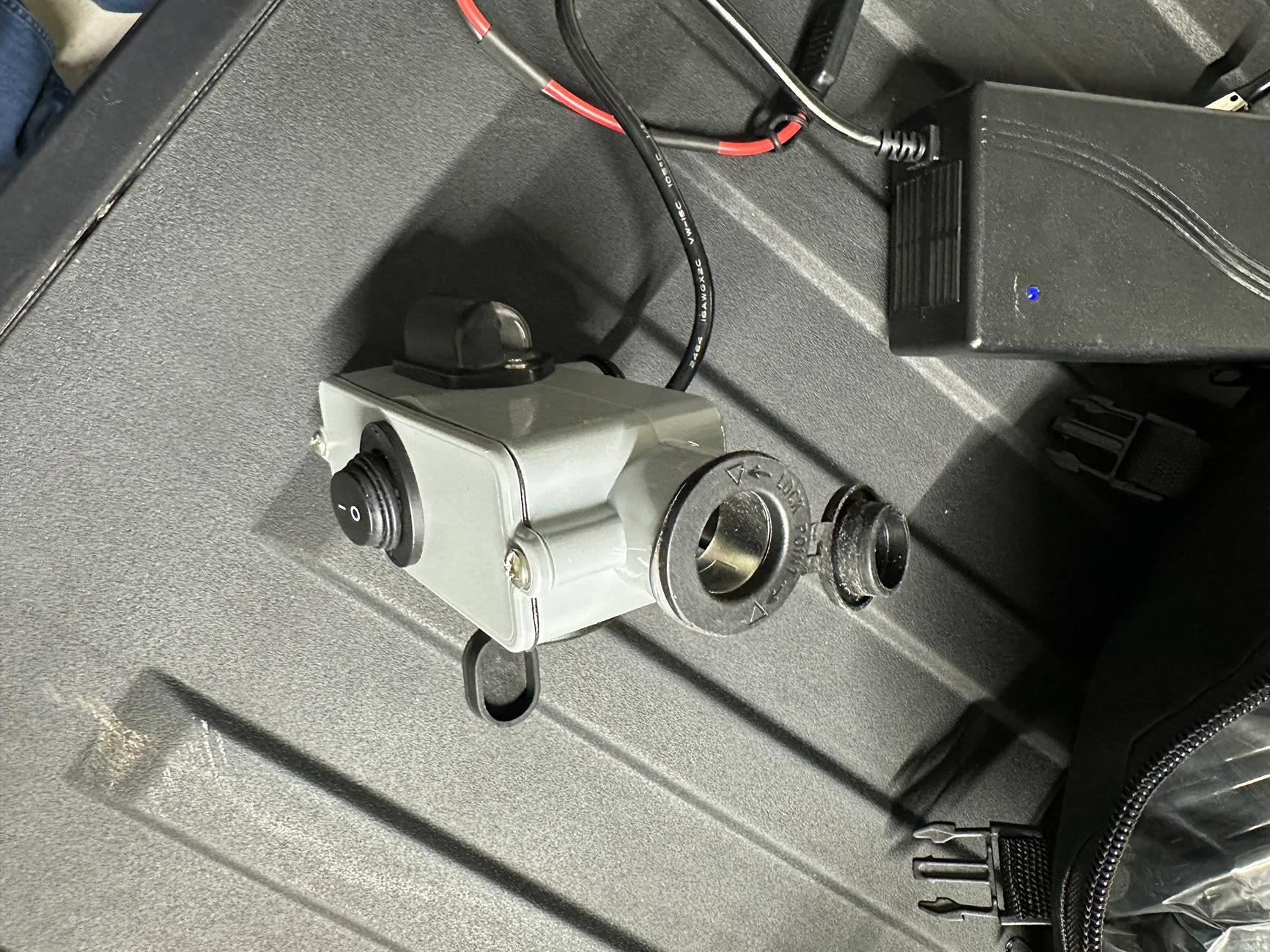

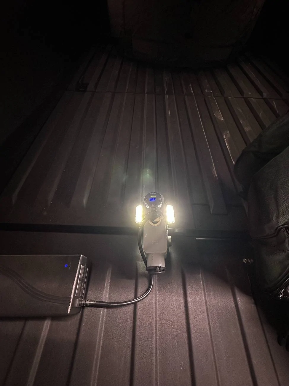

I wanted an alternative to the Tesla tire repair kit without the sealant (ā€œtire goopā€). Finding a 120 VAC portable compressor proved difficult, so I focused on 12 VDC automotive options. After some research, I chose the Viair 300P because of its positive reviews and reputation for quality.
Current Draw and Power Supply
  • Measured Current Draw: The Viair 300P pulls about 2.2 amps at steady state.
  • Power Supply Attempt #1: An 8-amp DC power supply didn’t work because the compressor’s locked rotor amperage (LRA) likely exceeds 8 amps. It actually short cycled.
  • Power Supply Attempt #2: A 30-amp unit (found on Amazon resale) worked perfectly.
Enclosure and Setup
I like the idea of a battery or kayak box with lights and power outlets, but I wanted everything—power supply included—to fit in the Viair 300P’s storage bag. The power outlet box gives the added benefit of a USB charger while tailgating. I caught the 300P on sale for $150 and found the 30-amp power supply on Amazon resale for $34.
PVC Conduit Box:
  • Perfect for the socket connectors once you notch them.
  • Using a heat gun softens the PVC enough to mount USB and cigarette lighter sockets into the conduit connector posts.
  • The posts help accommodate the length of the sockets.
  • I mounted the switch is on the cover (it requires minimal depth).
  • Cut the hole slightly small so you can screw it in.
  • I wired the switch only to the lights.
Viair 300P Set-up:
  • You will need to cut and splice an SAE connector to the end of the Viar cord.
  • Reuse the alligator clips to splice back onto a male SAE connector so you can use this with any other vehicles battery posts.
  • Pay attention to polarity with these type connectors.
Overall, the project was straightforward, and everything fits neatly into the Viair 300P bag. The final setup cost me around $256 and provides a portable, sealant-free air solution for the Tesla Cybertruck (or any vehicle you choose since it DC). The live links as of this writing cost about $289.
I’m sure there could be some improvements to this.

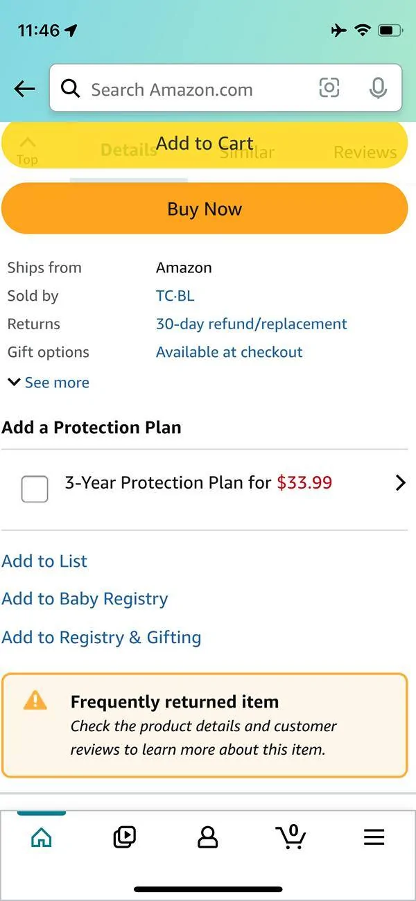

Buyer beware, ā€œfrequently returned itemā€:
