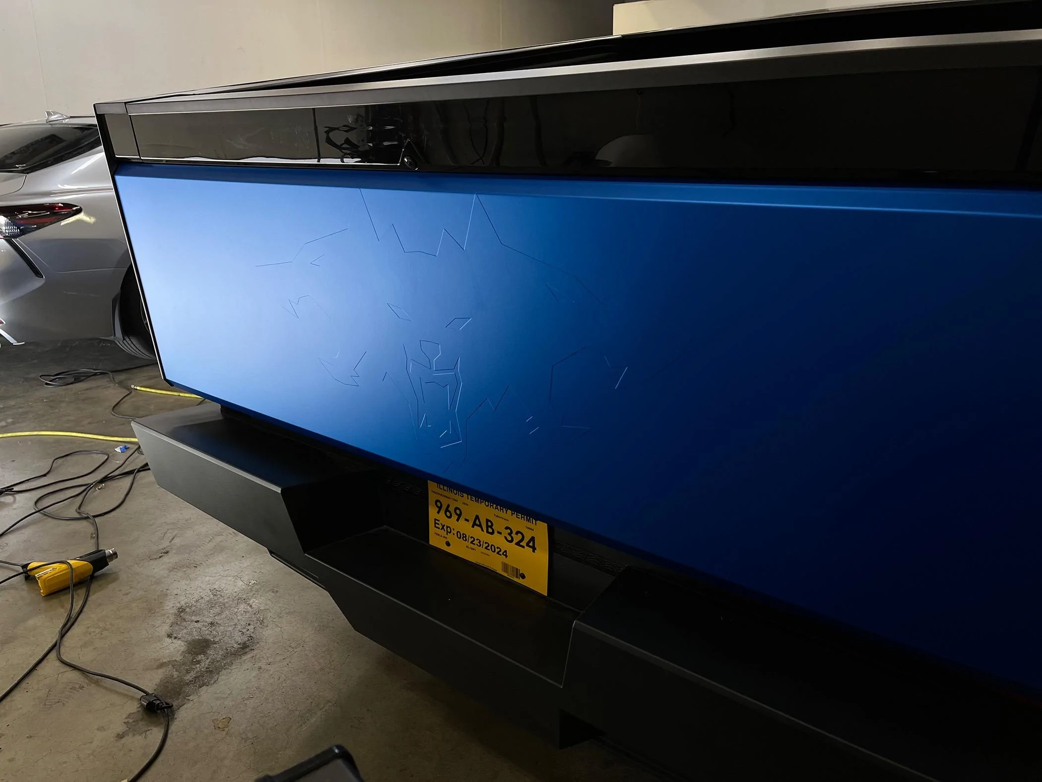

I wound up doing both, still not finished with the work and will post a more detailed view on what we did when complete. Went with vinyl on the base then did clear PPF over all of the black and front of car.
