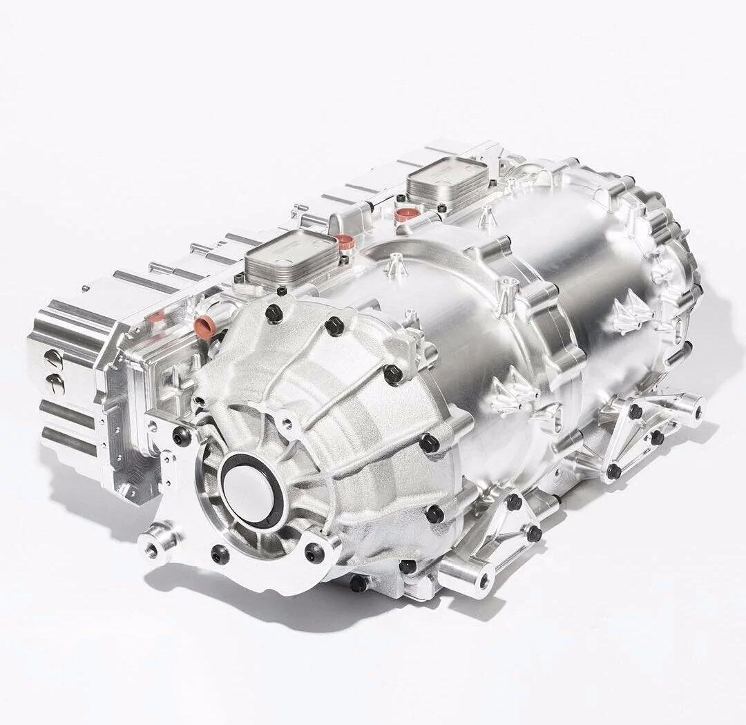

I was impressed by what I saw in regards to their motors. The motors they compared to are obviously Porsche Taycan, Model 3, and Model S motors. If there are no drawbacks to their motor (like durability or cooling) then hopefully Tesla can eventually match or beat their technology.
Also, in regards to motors, two months ago someone in a Tesla forum teased this image of the possible upcoming Tesla plaid powertrain drive unit (dual motors and inverters). It's not verified yet, but it seems very similar to the Lucid drive unit in its form factor. If this is really a Tesla dual drive unit, it seems to me that Lucid won't be ahead for too long (at least in size and tech).
Tesla Roadster 2nd gen Will Lucid come out with better battery and motor tech than Tesla? Mystery Drive Unit
