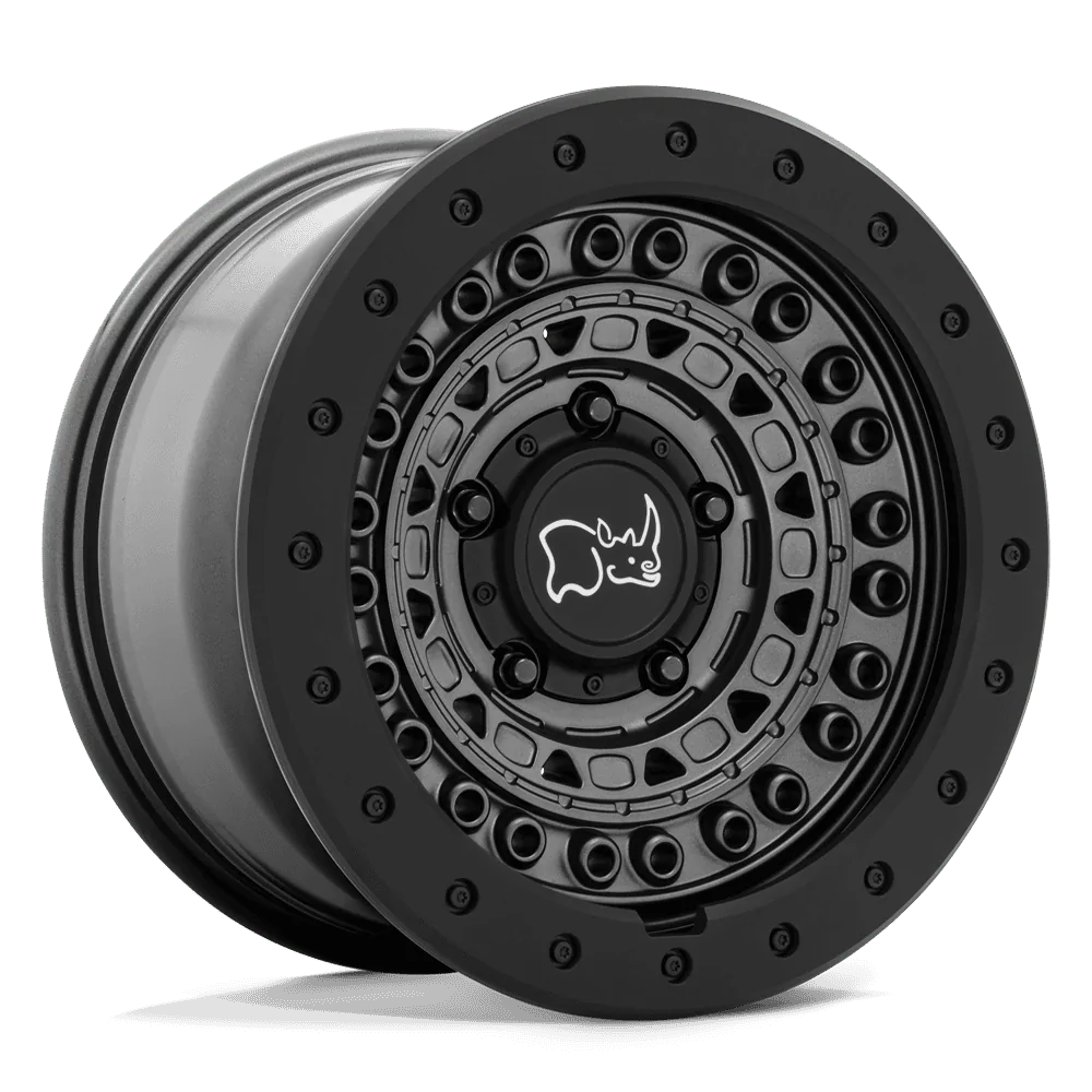

Will Black Rhino Barricade wheels fit the Cybertruck?

Yes, part #1890BCD006140G12 will fit. HOWEVER none of those wheels have the proper load rating. You need >1200kg or > 2645lbs per wheel. These are 2450lbs. If you don't offroad or load up the truck to >2000lbs, then it'd probably be fine.
Also, you'd need a ring adapter. If you have the equipment you may be able to lug-centric these, but it doesn't say, so I don't know on that one. If lug centric doesn't work, you can have them made here: https://www.uswheeladapters.com/shop/hub-centric-rings-aluminum/
Outer diameter: 112.10mm
inner diameter: 84mm
everything else standard is fine.

I was looking at these too, and sadly had to change my mind.
What @tmeyer3 said.
Although I know there are people that are installing wheels that do not meet the specs. I just don’t want to risk it because I have kids. In a past life, they would already be installed.
The beadlock 20 in wheels from @MartianWheels is likely what I will go with. They’ll pair well with the Baja Boss ATs that I already have on the CT.
does anybody know if The Black Rhino Barricade wheels will fit on the cybertruck? https://www.blackrhinowheels.com/black-rhino-barricade#
What @tmeyer3 said.
I plan on doing methods bead grips! Great load ratings on those and they're affordable.
