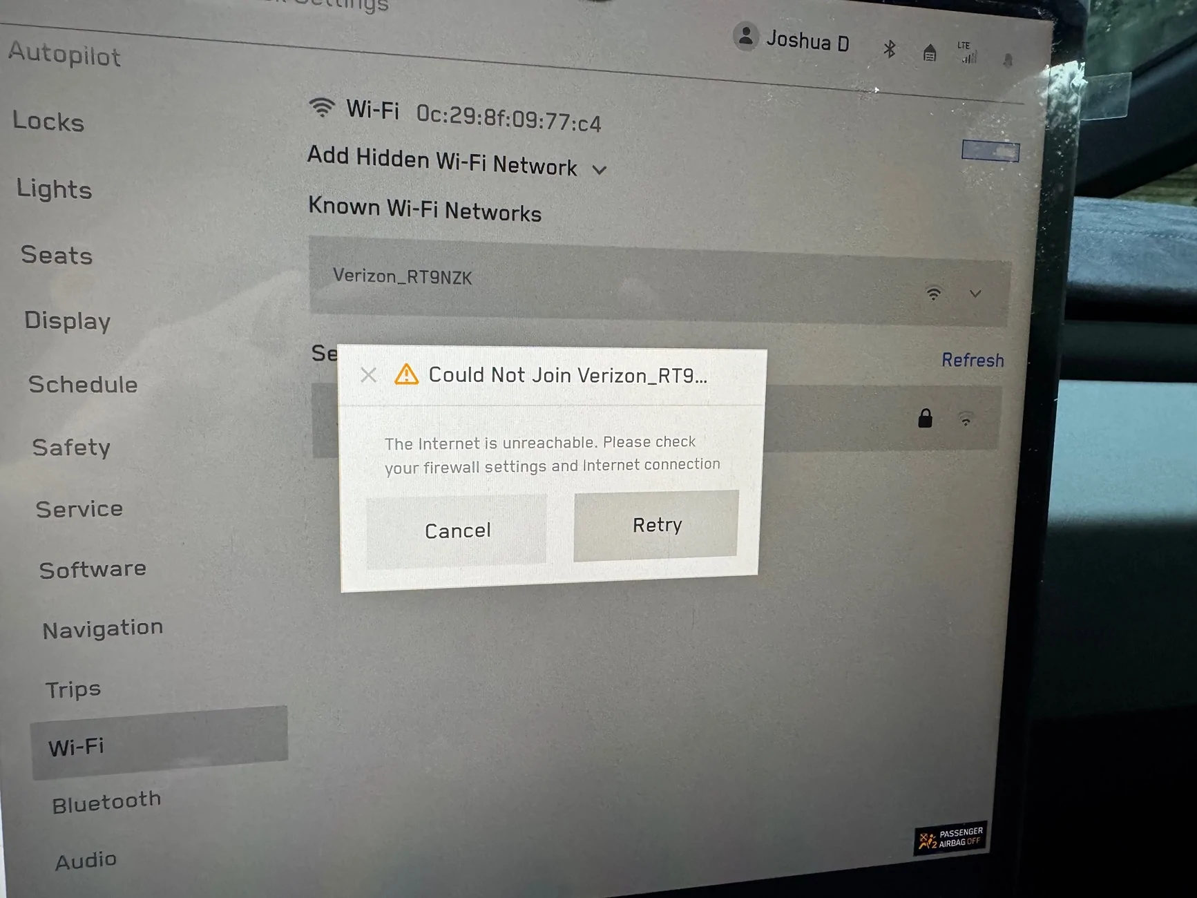

Since day one I have had issues getting my FSCB to connect to WiFi. The last update I had to download at the supercharger and install at home.
I have tried my iPhone hotspot, my home internet, the neighbors internet. It just will not connect.
any clue as to where the WiFi antenna is?
anyone else having WiFi connection issues?
I have reset using both thumb wheels several times.

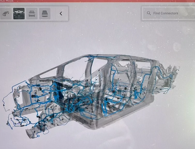

So, the TCU may need replacing if WiFi is not working, although it could be as simple as a loose connector. You can find it using Service Mode's "Interactive Wiring Diagram", which is pretty cool:
