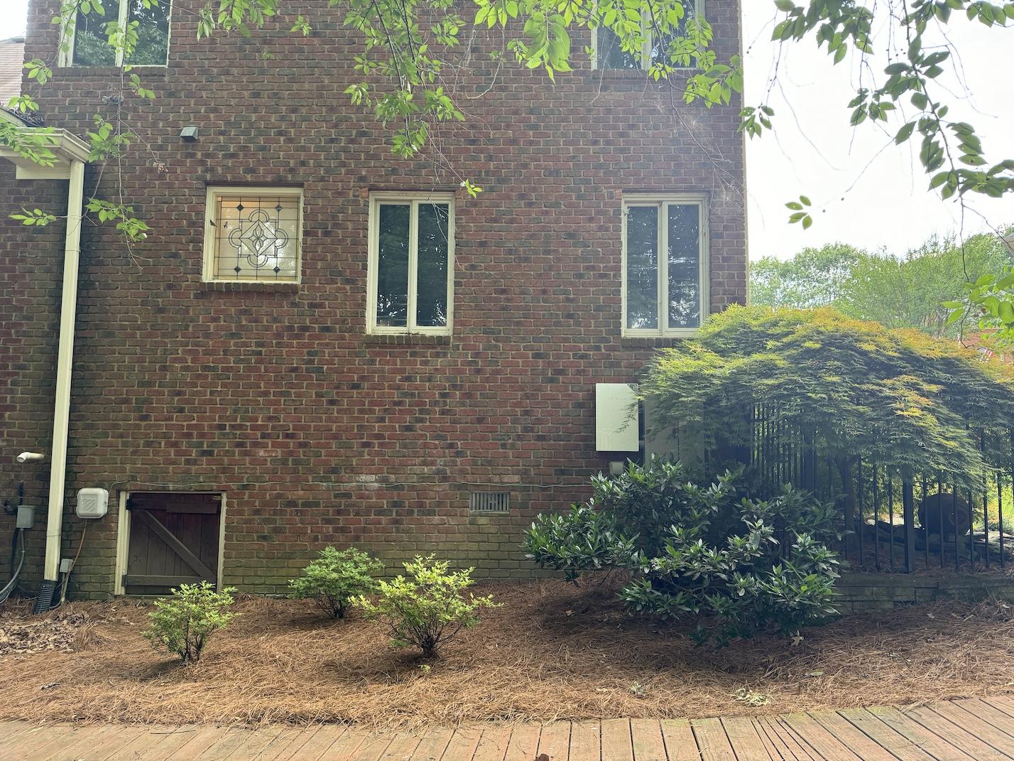

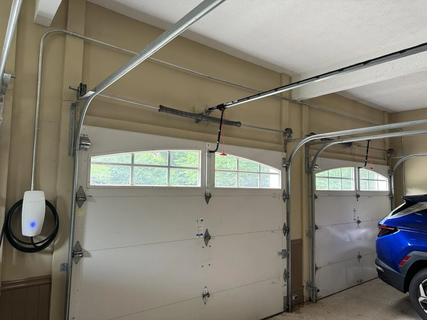

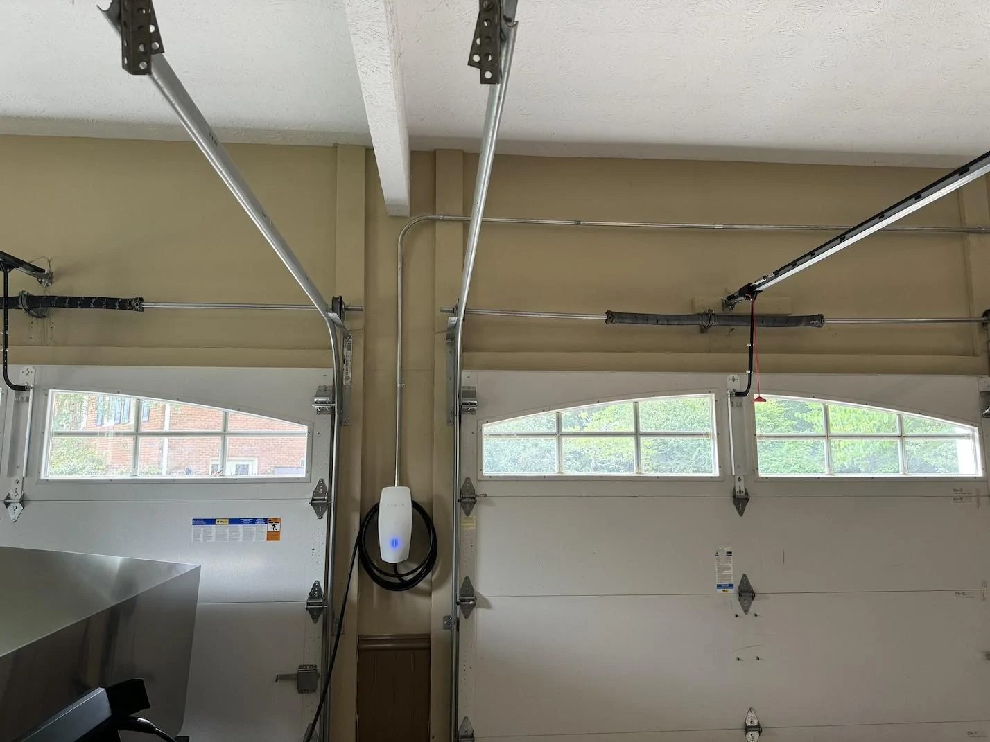

I had mine installed last month, the hardware was sent directly to the installer. The total cost was $3650 for the installation of both the gateway and the UWC, which seems very reasonable for the amount of work they did.
The PowerShare gateway is attached next to the mains on the rear of my house, and the UWC is in the garage from a new pull under the crawl space and run up over two of the garage bays, so it sits pretty much right next to my charge port when the truck in in the garage.
Excellent work, and I've already had a PowerShare real-world incident that went exactly as expected.
