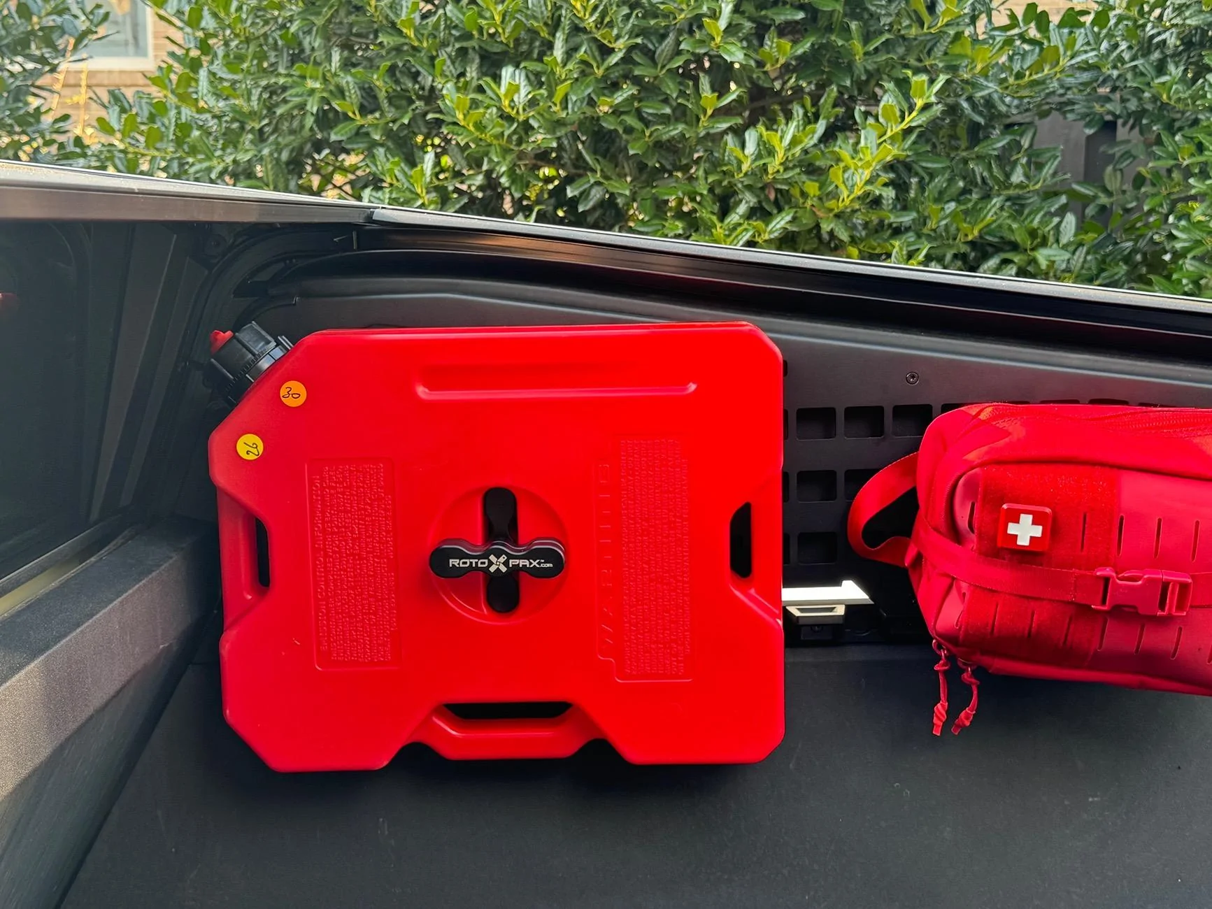

Rotopax are expensive and store half as much in the same volume... but they are pretty durable and easy to carry and attach.
Anyhow, interesting to see the solutions!
You could I think fit 4 of the 2 gallons on the side Mille panels (double stacked). Maybe 400 bucks. You have to modify the back plates.

Hi,
How did you mount the RotopaX mount lock to the Cybertruck molle panel? I presume the clamp is the RotopaX RX-LOX-PM Pack Mount Lock in the photo.
I am looking to do the same with a 2 gallon Rotopax water container and the photo (if that is a 2 gallon container) looks to be ideal.
Thank you!

Hi,
Thank you!
Phil
Yeah Im looking to do the same thing you are trying to do and I cant figure out how he dfi it on that picture
I bought the Rulline mount on mine. With the raised mounting holes, I ended up drilling out two of the other holes on the flat side so the bolts would fit (the bolts were too short to thread into the bracket with it reversed in this position and the raised areas would not fit in the rectangle holes of the Molle panel. The smaller holes were slightly off center, so I had to drill them out slightly oversized of the bolt diameter.
