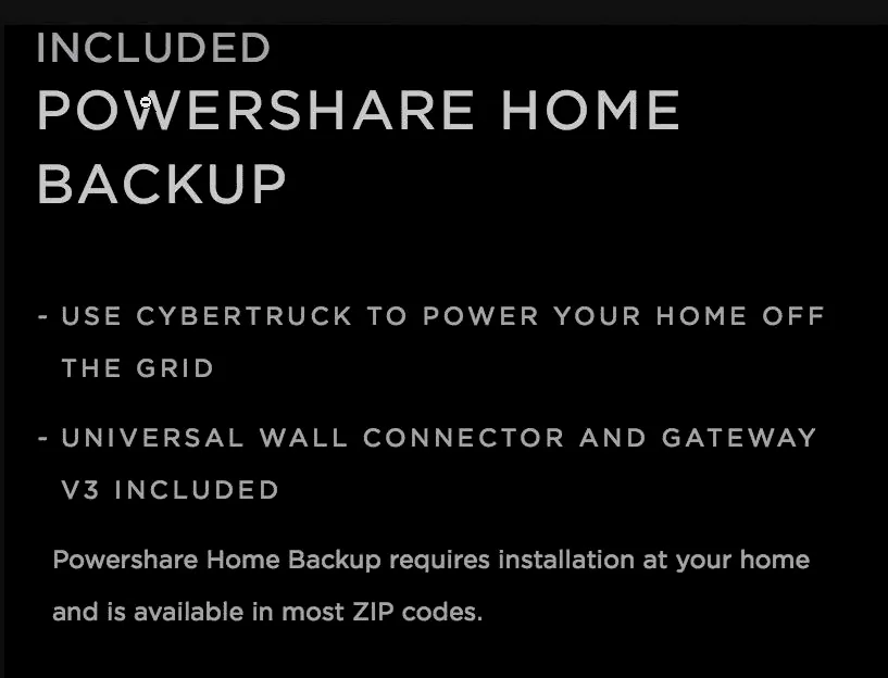

I think it remains to be seen, but on the order page it does say "Powershare home backup requires installation at your home".
So.... unsure if Tesla could simply itemize this, and just send folks a wall connector.

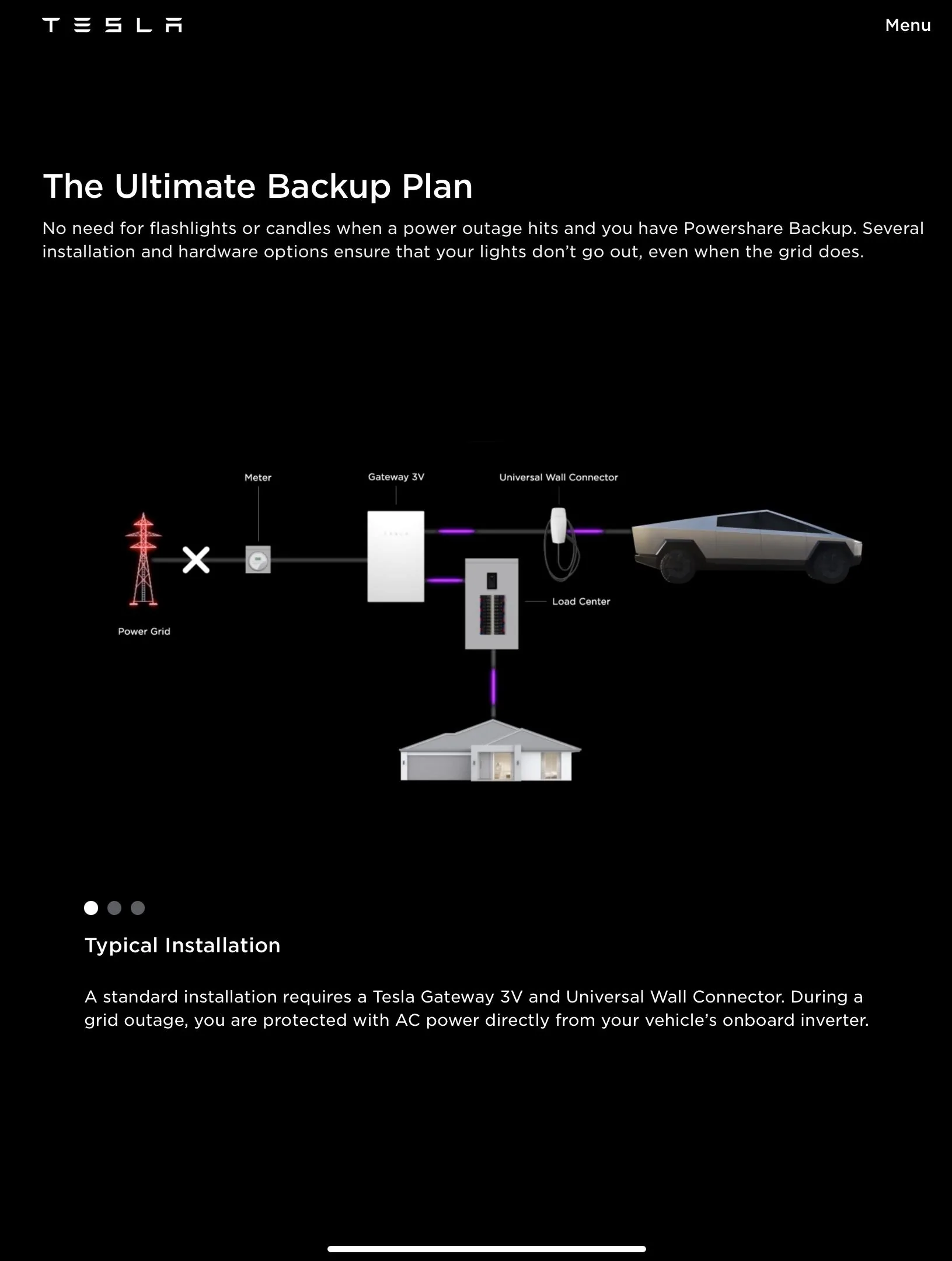

Image from Tesla website.
It appears that the Gateway V3 will mount outside next to my meter and the universal wall connector will need to interface directly to the gateway. If i were just mounting a normal wall charger, it would interface to my load center in my garage With a 60amp breaker.
Considering my meter is on the opposite side of my house to the garage, installing PowerShare is going to be much more involved.
I guess it makes sense that they don’t want to back feed the load center with the universal wall charger even if the gateway isolates the primary feed during an outage.
Ya but Universal wall connector is a standard charging item independent of anything Powershare related. For the FS premium, if they deny that based solely on principal I will cancel my order considering the FS is already a rip-off to get early delivery.
