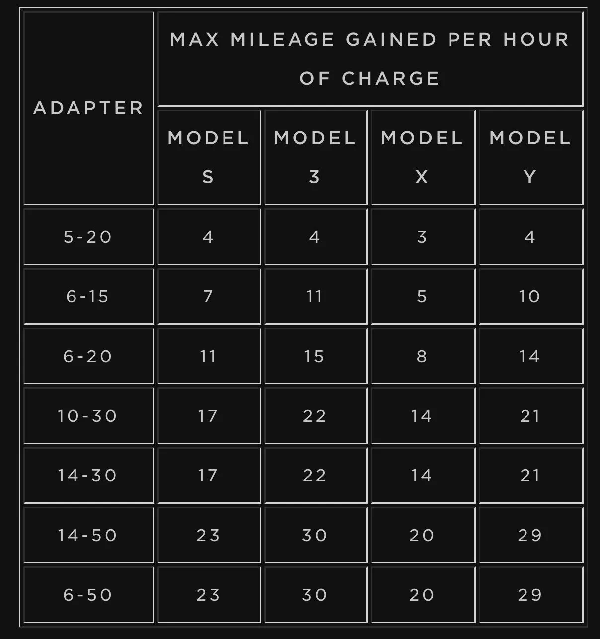

The Mobile Adapter is included with the shipping trucks. With the right adapter, you can charge off of just about any plug Gen 2 NEMA Adapters (tesla.com)

The scary part is, I have yet to see/hear of one person getting the PowerShare Gateway V3 and the Universal Wall Charger installed.
Not one. So that means, you might be waiting awhile before that install happens. You need a plan B. Either use the local supercharger or get a NEMA 14-50 plug installed.
I plan to upgrade my NEMA 10-30 plug, but I am not sure if it is worth the effort & expense as a temporary solution. The NEMA 10-30 adaptor from Tesla is $45. Not sure how much the install + materials are to upgrade to NEMA 14-50.
