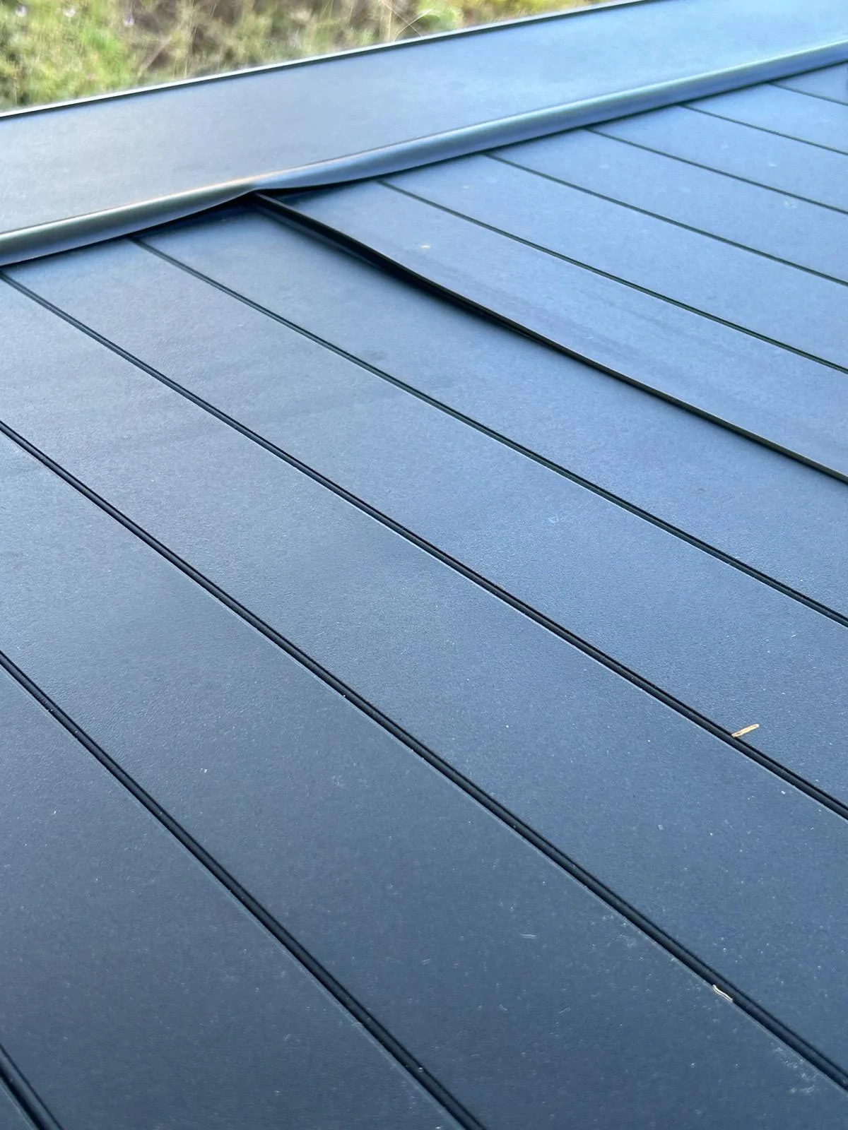

I’ve only opened and closed the tonneau cover a handful of times but I just notices of the gaskets between the lovers has failed.
Anyone else seen this?

And BTW it looks like it’s exactly same as mine. Like maybe the same location.

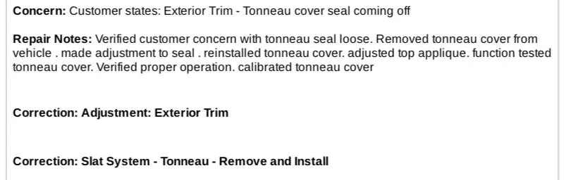

Got mine fixed as well. Asked if I can do something to prevent this happening again. They said it the top trim needed adjustment.
All slats and seals are perfect now. Hopefully it stays that way. Dropped off at 7am was ready by 3pm
