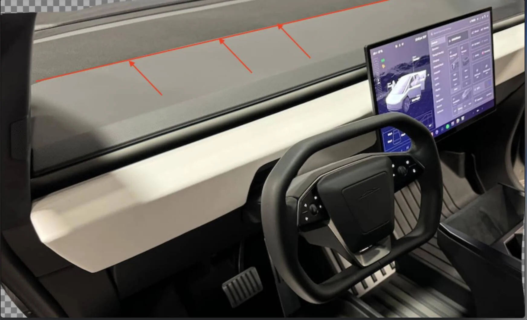

I "may" have isolated one of my last rattle locations. Still one to go after, but this for sure is the area as I can press down or lift up with my finger and it stops. Right where the long red straight line is, arrows pointing towards, that part lifts up, can get a finger under it, or press down, and rattle stops.
I'm going to maybe put some weather stripping just under it and I think that'll solve mine.

Have you isolated where yours may be coming from?
