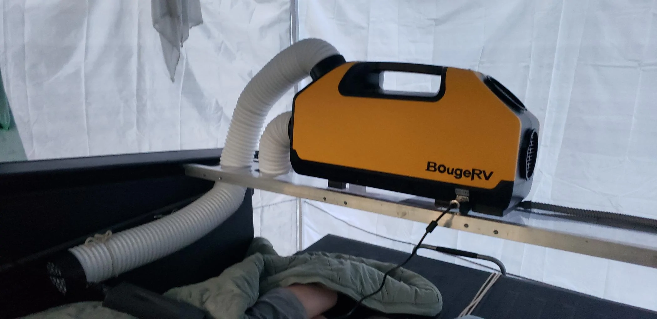

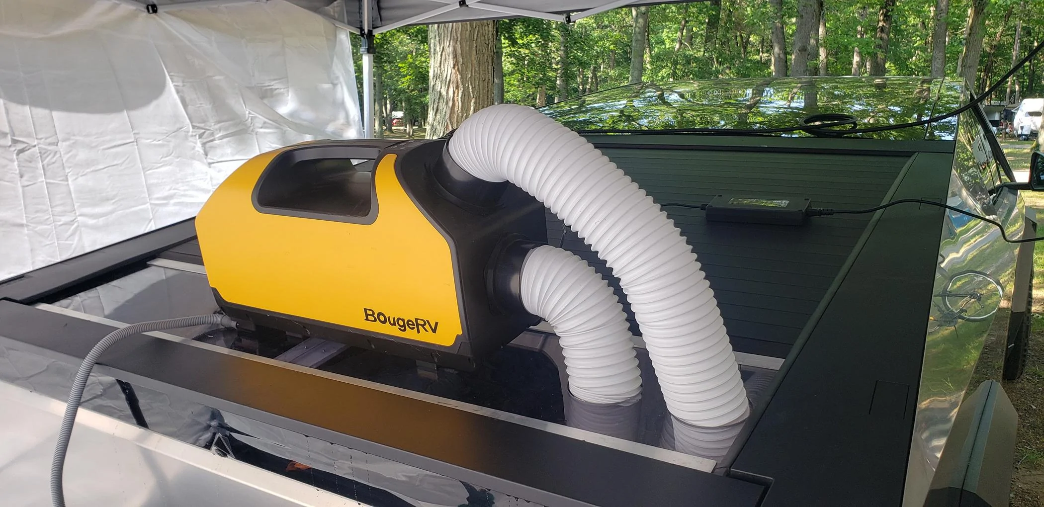

The next night I used the BougeRV A/C to provide forced ventilation. I set the thermostat to 74F and ran it at the lowest fan speed. It controlled the vault temperature perfectly. The sound of the unit was not an issue for me, but my companion found the on/off sound of the compressor relay somewhat distracting.
Tesla Cybertruck Tested: Sleeping in the Bed Vault BougeRV 1
Tesla Cybertruck Tested: Sleeping in the Bed Vault BougeRV 2
The loose connection of the short white 4" air intake at the Lexan support panel allowed fresh air to mix with vault air. There was no issue with humidity, and quite a lot of water drained from the unit overnight.
I powered the unit from the campground electric service pedestal, because the vault outlets are inactive when the CT is being charged so I don't know how much battery energy would have been consumed. My previous testing showed a power draw of about 150W. The unit can be used for air exchange only (no cooling). I don't use it for heating the vault in cold overnight temperatures, preferring the use of an electric blanket.

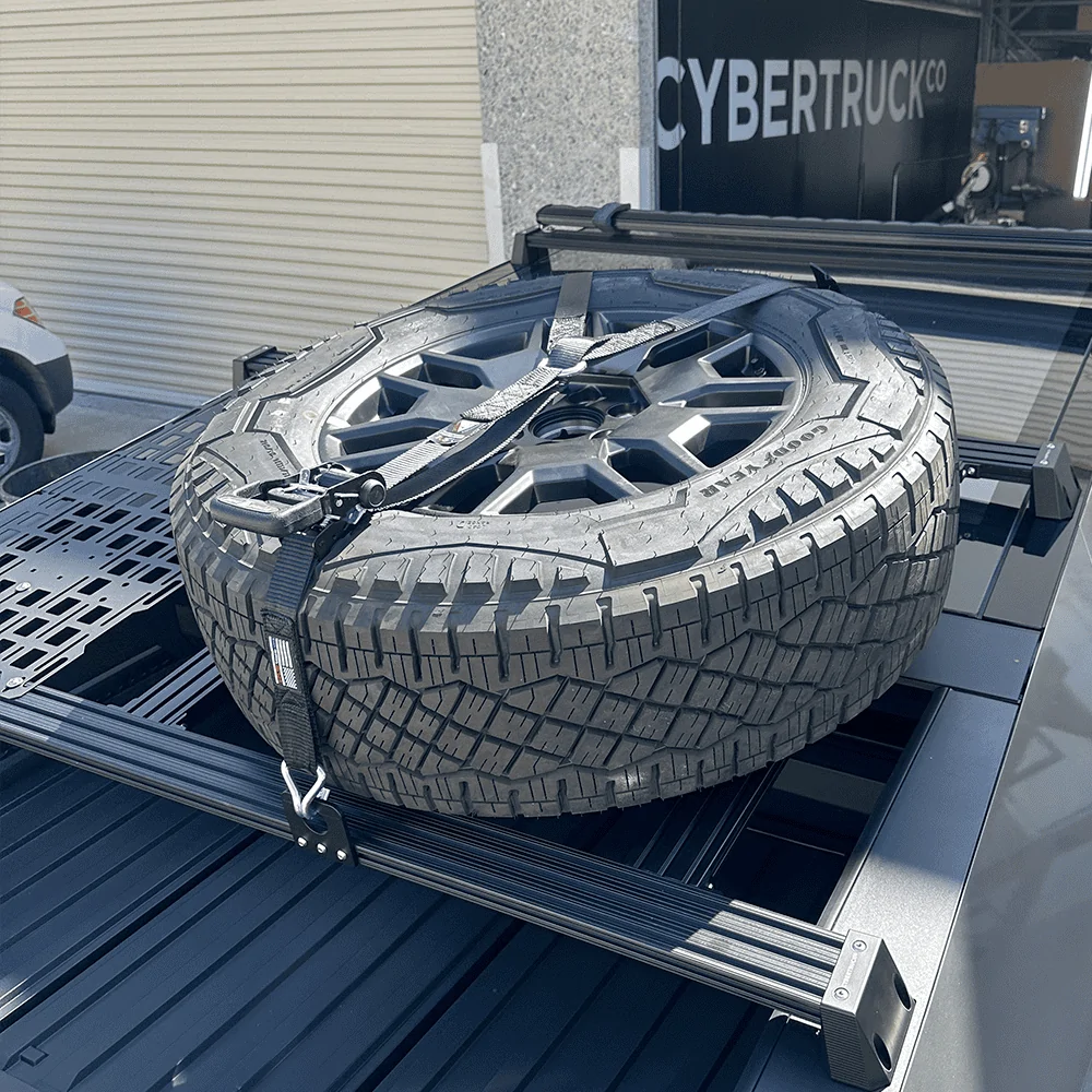

I only expect to bring the spare on off-road trips where getting an unrepairable flat and calling for a tow would be rather inconvenient, not to mention expensive. That spare is gigantic and weighs 96 lbs. Transporting in the vault is not practical in most cases when boondocking off road. I plan to install a rack half over the sunroof and half over the vault to carry the spare. Something like this:
