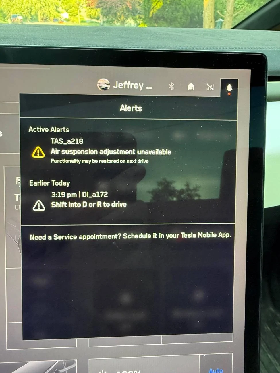

It’s not normal as I undoubtedly discovered myself.
Mine as from my original post, has been making this noise to just recently since back in Nov 2024 with increasingly louder and louder operation & for longer periods of time as well.

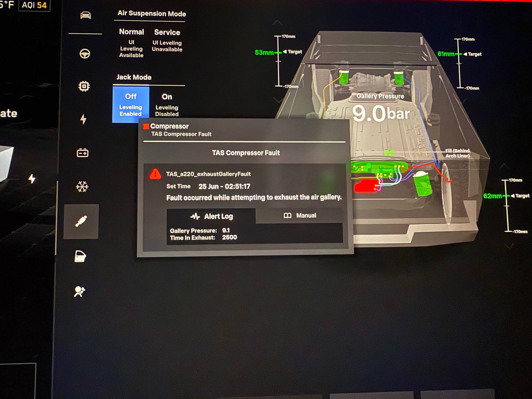

When I say recently, it’s because now I have a permanent error code TAS_a218.
under service menu there is also an error TAS_a220_exhaustGalleryFault.
The a220 error will indicate the the TAS (Tesla Air Suspension) is in limp mode and will be disabled til service, which I now have scheduled for June 9th 2025.
Something to also be aware of is that this issue began back in late fall - winter months but as temperatures remained cold, the noise and cadence of the issue was essentially random.
As the temperatures started rising from spring on, the noise grew worse from random to all of the time while driving the truck, to the point the other day on a 90°F day in PA and very muggy from rain, threw up those 2 errors upon entering my truck for a drive.

I've noticed in the Service Guide a procedure for replacing the Air Compressor Exhaust Assembly, which the EPC refers to as a "muffler".
Tesla Roadster 2nd gen Suspension compressor noise suppression Screenshot 2025-06-26 at 3.35.04 PM
It seems to be loosely fitted, so it's a possible source of noise if detached or defective.
Although it may fix an exhaust gallery error, it certainly is not the source of the Very loud banging/rattling noise that the compressor makes while it’s operating for many minutes at a time.
see attached video of loudness just sitting in my driveway and it gets louder as you drive around: it’s embarrassing, for what should an otherwise silent function as in our model S & X plaid.
Other owners have indicated that service found it to be the mounting bracket that the compressor sits & instead of the rubber grommets absorbing that vibration, the metal hits the bed frame making it sound like a rata-tat-tat-tat-tat constantly until minutes later a loud burst of compressed air then pure silence again. The longer the issue goes the louder it gets to a degree, I’ve been tracking the issue for months trying to get to the bottom of it.
