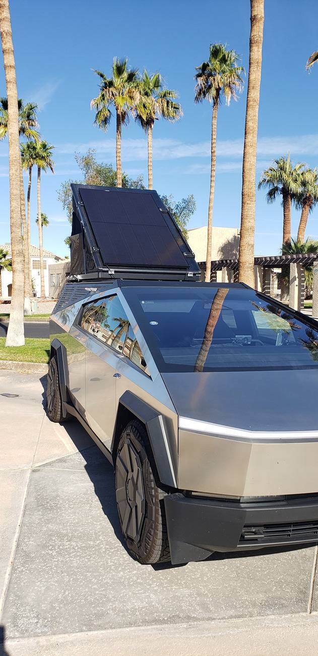

I have done the same. I used a 420W REC solar panel charging a 2580Wh LFP battery with a Renogy 20W Rover charge controller. I charge my CT using a 1000W inverter at 8A. The battery is constantly being charged from the panel as the truck is being charged. Even on a good sunny day, however, the panel tops out at 320 to 340W so eventually charging stops to recharge the solar battery. The issue I've found is that the efficiency charging this way is very inefficient, less than 50%, making the charging process extremely slow. I use my CT's solar generation to supply power for accessories - refrigerator, tent A/C, electric blanket, Starlink, camp lights, etc.
