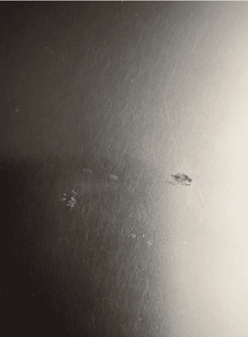

Thanks for the feedback everyone. Here is a picture, and I would agree that its probably better defined as a large scratch and not a chip. Each of those spots is probably 3mm wide.

You'll have to refinish the entire panel for it to match. Since there's no other neighboring panels on the same plane you should be able to just do that panel:

Thank you, that was very helpful. I think that waiting for more scratches before refinishing makes sense. I wonder if we'll see this as an offering from detail shops at some point.

If you get a chance re-post your photo with dime, penny or even a 6" ruler next to the "chip". That would really help with perspective.
