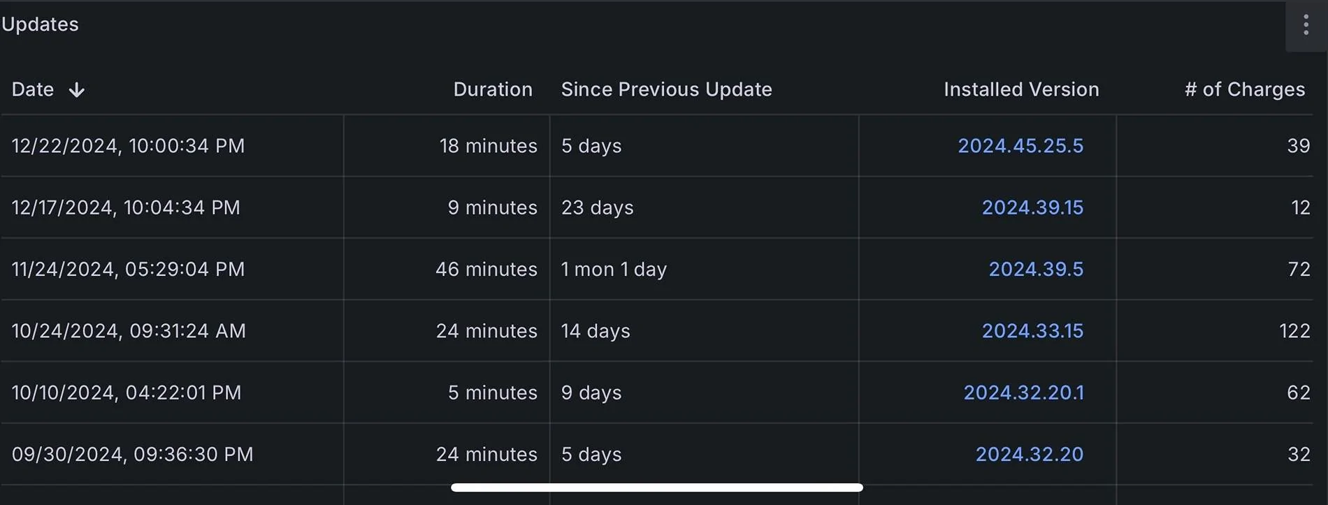

The latest update has increased the vampire drain again on my AWD. The three or four versions prior had resolved the drain issues making about the 1%-2% range for 24 hours. On 2024.45.25.5 it is crazy again, I’d guess 4-5% in 24 hours. Give them time, it will get better over time. Our 2022 X will sit asleep for 4-5 days and drop as little as 1% up to 3%
I do think one thing that makes our truck use more juice is our phones wake it up when we go in the garage. We keep the fobs for the X on the other side of the house allowing it to sleep for days.
I will post some vampire drain stats later, lazy right now.
Last couple firmware version on the truck. For sure 2024.39.15 and 2024.39.5 had less vampire drain.

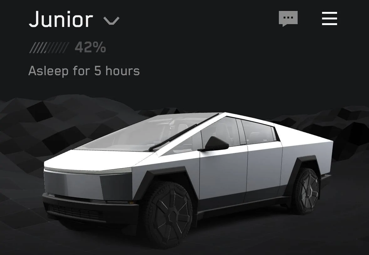

Sleeping is the lowest power mode. It should show in the app:
Tesla Roadster 2nd gen Significant battery vampire drainage in storage IMG_0647
Of course, it will wake if you interact with it, but should go back to sleep in minutes (I’ve not timed this).

The truck is parked at Home, and I have Sentry specifically disabled for this location. I did a walk around (without my phone) to see if the screen will wake up due to Sentry, and to listen if the HVAC is running a couple of times, and didn't notice any activity. When I opened the app yesterday and the day before it did say it was asleep for X hours before the app woke it up and updated the SoC report.

You're exactly correct. Once the pack has cold-soaked to whatever the ambient floor is, you're not going to see any more "loss" from that corner. Continued reduction in SOC/range would have to be coming from something else.
If you see "Asleep for xx hours" when you open the app - and that time asleep roughly corresponds with how long since your CT was being driven or charged, that would largely eliminate not-sleeping as the problem.
If that "Asleep for xx hours" is something less than what you expected, then you need to find out what is awakening your CT.
