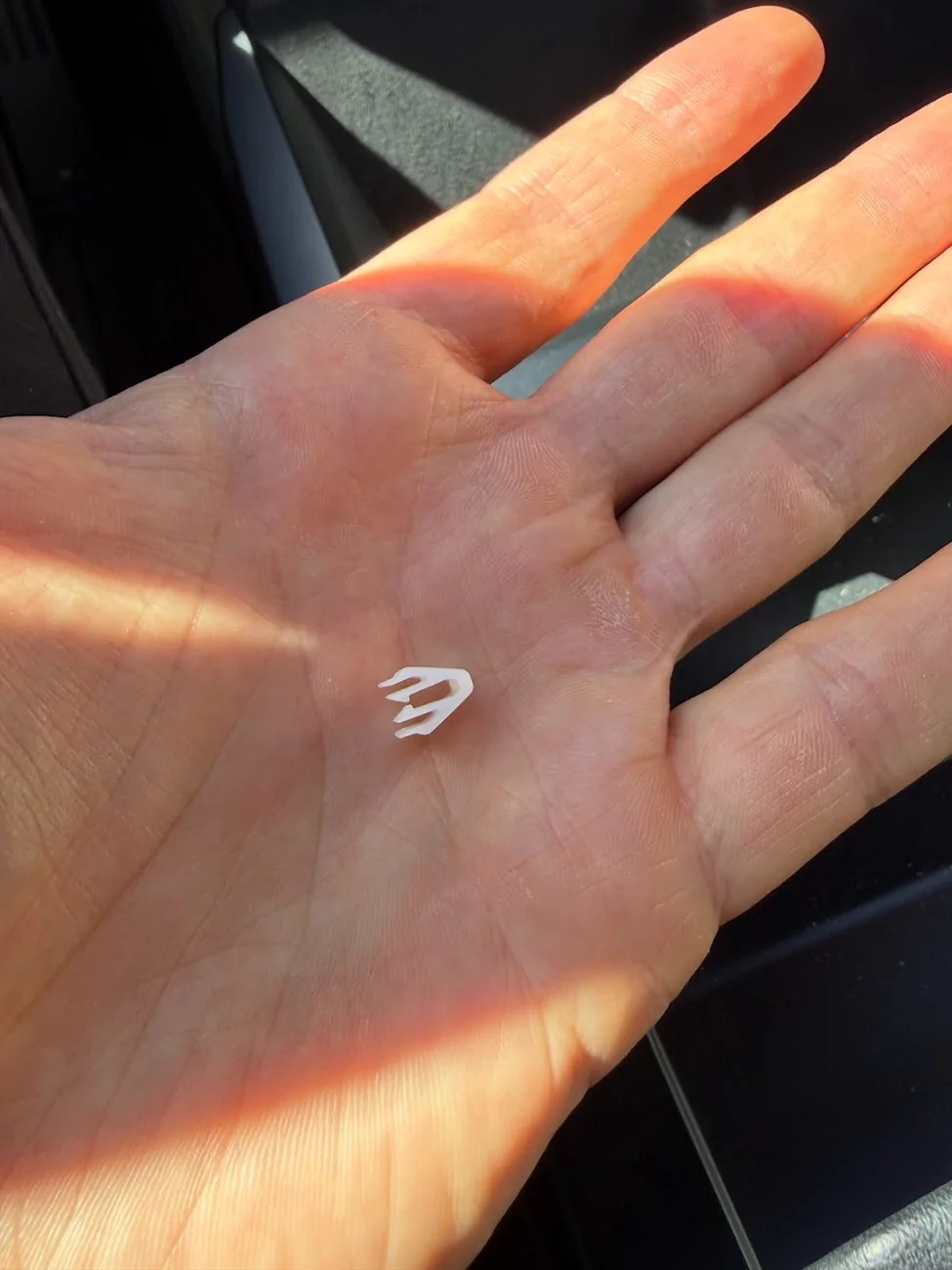

I also found this clip on my truck after picking it up. Any idea what it's from?
Tesla Cybertruck Service Questions and Sanity Check IMG_0890
Tesla Cybertruck Service Questions and Sanity Check {filename}
That looks similar to the clips that hold the beauty cover onto the windshield behind the rearview mirror, but I suppose similar clips are used throughout.

Thanks for the input. Maybe just a loose clip then. I see no evidence anything is loose.
