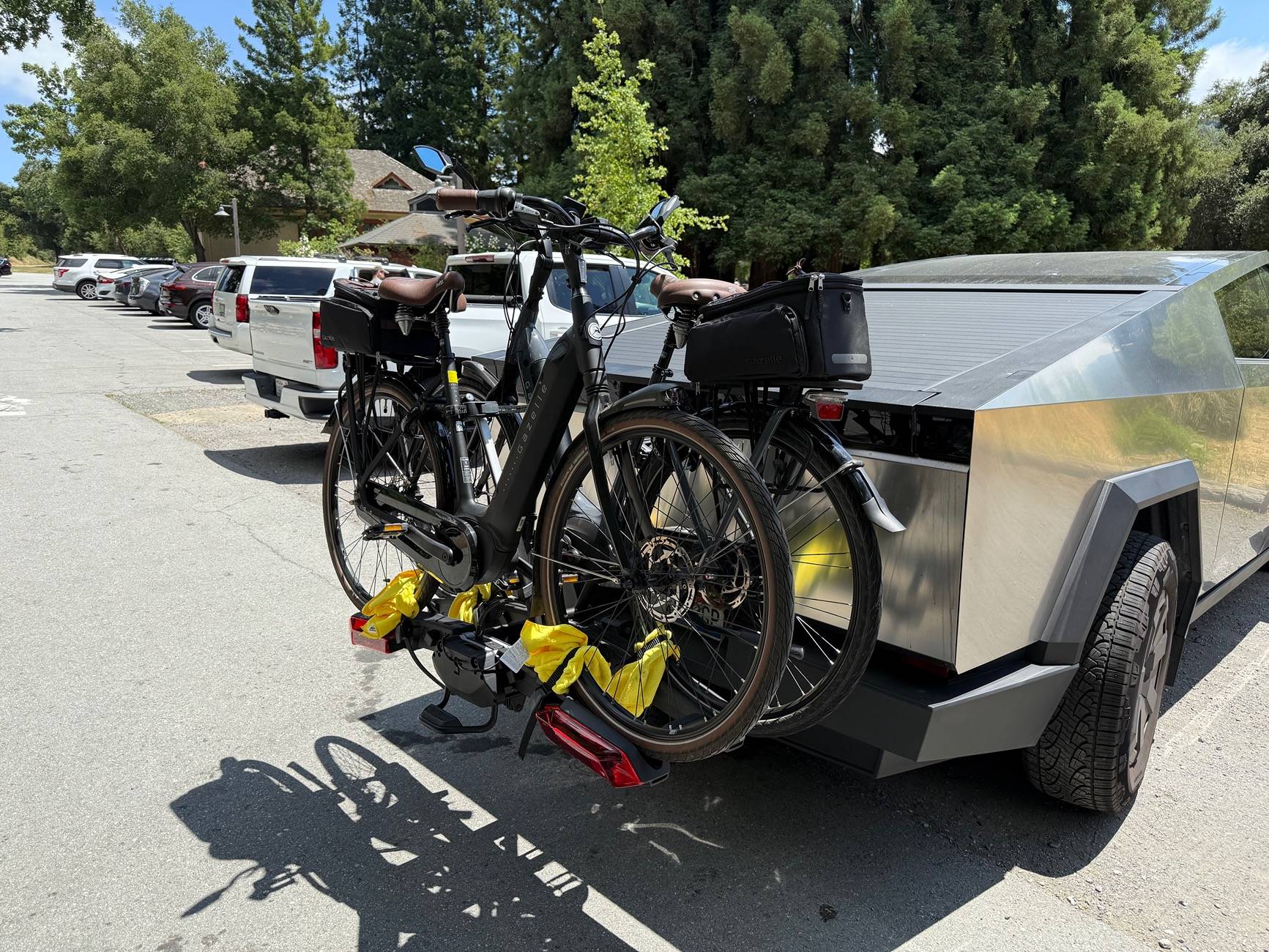

I use a Thule (Epos 2 903211) 2-bike rack, with two e-bikes. Rack is 40lbs, bikes max 60lbs each. When checking in the ā€œmirrorā€ it wobbles a little bit, but feels very stable.
Tesla Roadster 2nd gen Question Regarding Carrying E-Bikes On Hitch Mounted Rack IMG_5470
Tesla Roadster 2nd gen Question Regarding Carrying E-Bikes On Hitch Mounted Rack IMG_5442
