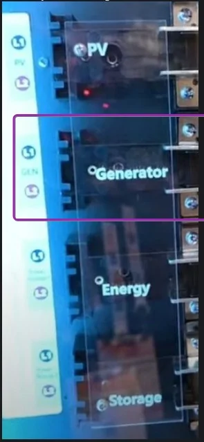

Aside: Been planning for our Western NC house build for a few years [obviously I've refocused on power outages after being without in our rental for 6 days]. The house is almost all electric with 400 (320) amp service. I believe that the normal configuration is two 200 amp panels. I'm thinking my simplest configuration is to have one panel be all the 'Backed-up Home Loads'.
- I would have a Powerwall for millisecond islanding (Powerwall v3 has 185a LRA, LFP batteries, and is supposed to be compatible in future and I could add ~$2K cheaper future powerwall extension units)
- I could either have a Gateway 3V attached to it and/or a transfer_switch and its generator_plug (ala receptacle from CT bed 14-50, Anker F3800, or gas generator)
Attached are just related specs, info.
