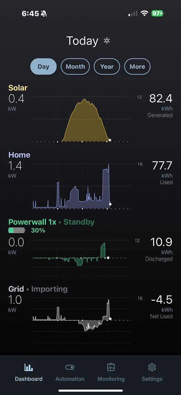

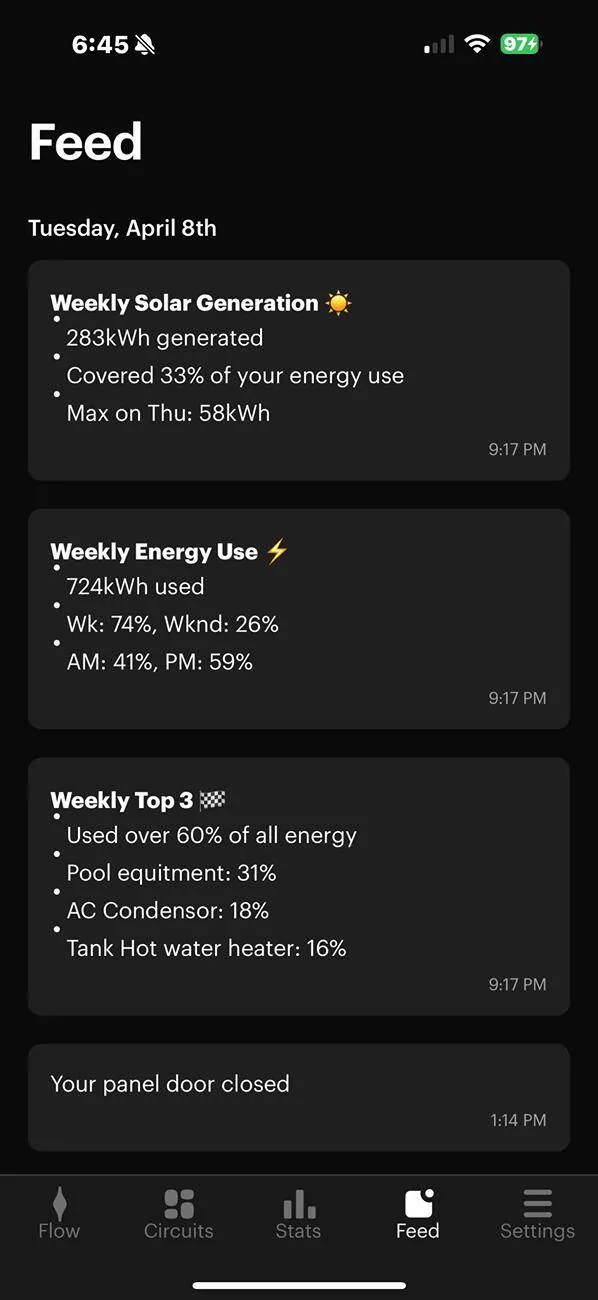

Glad to hear you're enjoying your Cybertruck and PowerShare setup! Using a Span panel with just PowerShare initially should work well for load management during outages, especially in Florida. The Span panel can control circuits directly, giving you flexibility to prioritize essential loads using your Cybertruck’s power. It integrates smoothly with PowerShare, though you’d need a Tesla Gateway for full functionality. Adding Powerwalls and solar later is totally doable—Span’s designed to adapt to battery and solar upgrades.
Tesla Roadster 2nd gen PowerShare with Span Panel 1744248156744-wh
Tesla Roadster 2nd gen PowerShare with Span Panel 1744248068307-5n
Tesla Roadster 2nd gen PowerShare with Span Panel 1744248092364-gc
Tesla Roadster 2nd gen PowerShare with Span Panel 1744248116479-l2
