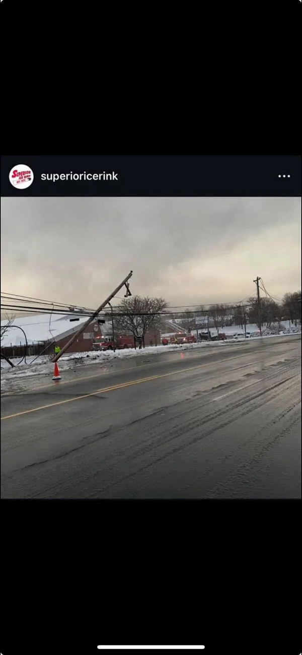

Would have been nice to have this morning.
It’s been installed at my house for over 3 months now and still waiting.
Lost power in the early morning hours. Woke up to a cold dark house. I was able to get my generator on and running for a few hours before power was restored. But that required me to get dressed and go outside to plug everything in and turn it on. Instead if the power share was working I would have woke up to a warm house and a hot cup of coffee.
Waiting and waiting. Let’s hope they get it working soon. Only a few more weeks of winter to go.
