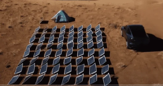

For instance Power of Light charged his Model Y but it took a couple of days and a LOT of panels before he could move on. You are going to be better off with a small generator, or waiting until the CT v2 comes out with a larger battery.
